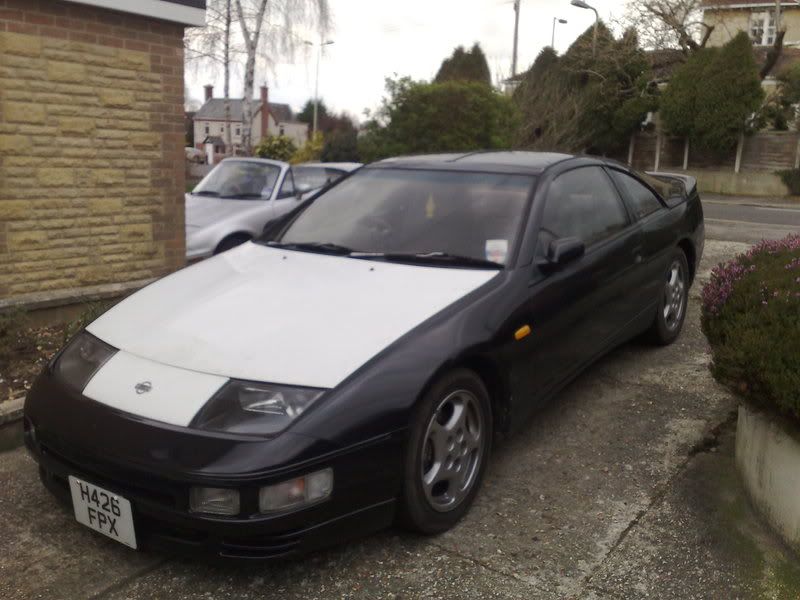

ok all sorted got the bonnet off on my own just gunna get everything else bak on now.
I dont think it looks too bad! eat ur heart out StellaZ. lol
:rofl: :rofl: :rofl: he should like that mate.
