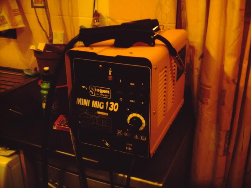

Well ive been on about teaching myself to weld for ages, so bought one of these:)
Got several books and DVD to teach me and now to practice......right where did i park the skoda LOL

you will get better results using a inert gas rather than gasless wire, remember learning to weld and being really proud when i could get sweet v's in my welds, get a auto darkening mask as well , it does help
Good luck try not to set your hair on fire from all the sparks, as Retro620ti say use gas (argoshield light) as the nasty chemicals in the fluxed cored wire will turn your brain to mush. He's right about the auto darkening helmet as well as you will be starting the weld in the correct place instead of three inches away from where you want to be.

The best advice I was given when I started to weld was make it sound like sizzling bacon, welding is easy its the setting up of the rig that is the hardest bit.
As said don't use gasless you will just blow holes in everthing and get disheartend.
Have fun
Made sure i got a gas one, was advised against a gasless one
BOC's prices have gone up since I signed up with them in 2000. It's about £40 a refill now, so make sure you knock of the main gas tap when your done!
Does anyone know how much the autodark masks cost? I just bought a normal one for £15.
Looks like the front cover lens is a strange size, you may find it difficult to get replacements once they get covered in spatter.
