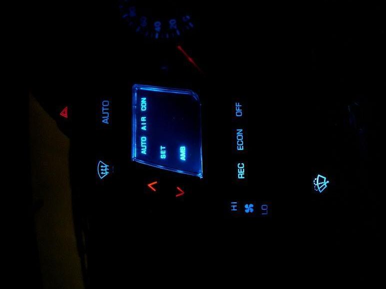

I have fitted the LED lights in the pods and the dash, but was wondering how to get the windscreen wiper symbol lit up. I have looked on the how to's and viewed olliex's posts but not clear on how to do this part. It looks like there is a small rectangular bulb holder, but doesnt seem to want to come out.
Any ideas appreciated.

I managed to get the bulb holder out and it has the long bulb, similar to the hazard one, the 3mm led fits into the hole but need to work out if i need to put a resistor on or not, will give it a try and let you know. Although at the mo i cant get the air con pod leds to work, ive tried reversing the polarity and still nothing. Getting frustrated, i spent 3 hours last night messing around with them.

I found it last night, my only problem is that the leds are not very bright so i have ordered some brighter ones from ultraledlights.co.uk. I got them all working but you can hardly see the ones in the air con pod.

I got Olliezx's mobile off here but dont want to call him as he doesnt know me from Adam, i got the new leds this morning and resistsors and i have noticed the 12v resistors that came with them are slightly different from the ones i got from Maplins which might explain why they are not very bright. After hours of pfaffing about with the pods i now now them inside out and have all the leds working, just not very bright. Once ive re-done them i and i have success i will do a whoopee post.

The resistors i got from maplins are crap and differ from the 12volt ones supplied with the new leds, they were supposed to be 470 ohm but the muppet behind the counter picked em out and gave me the wrong ones, needless to say i should have checked also but i was new to resistors and didnt know any different at the time.
Now the leds are how they should be. I'm glad i had problems though it makes you learn more about what you are doing and makes it easier to explain to any one else with led problems.

take out the rubber bulb holder as you will be using the channel of the holder to run the led through as olliezx said, the head of the led will sit in front of the hole of the channel next to the wiper switch. You will have to take out the wiper switch assembly from the pod which is shown in the aus300zx.com pics then using a small flat screwdriver prize the wiper switch assembly apart being careful of the switch gear inside not to lose the ball bearing at the back of the white inner switch mechanism.(sounds more complicated than it really is) you will then see how the led will need to run ie: in an L shape, as olliezx says, make sure you put some heatshrink on one of the legs of the led to prevent shorting out. The easiest way to find the positive terminal for the led placement is to look at the assembly from above with the switch in your right hand, the positive terminal is the one closest to the switch, making sure to pre-solder the terminals first as they are copper/brass and will require more heat, than you will want on the led. place the led in position with the legs pointing upwards as they will need to go through the housing and stick out of the hole where the original bulb holder was. Clip the assembly back together then solder the led to the terminals. You will not be able to solder first then clip back as the head of the led is on fron of the hole for illumination, unless you use a 3mm led, in eather case its still easier to solder after you clipped the assembly back together.
The resistors need to be 12v or as some people have used 470 ohm, some have used higher ohm resisters, but 470 ohm is the recommended.
Sorry for being a bit long winded, ive probably made it sound more complicated than it actually is, but have a look at the aus300zx.com link above to see pics and it should become clearer.

you have to place the legs of the led through the hole first ie: from the switch side into the casing. Remember to carefully bend the legs to an L shape, as it goes into the hole then the legs point upwards, place the top assembly back onto the switch base with the legs going through the bulb holder base. Try to bend the legs on the led so that the annode leg IE one with the resistor is closest to the switch. You will need a 470 ohm resister with either 3mm or 5mm led.
Note you will need resistors, regardless of led size if using to replace any normal bulb.
I also used red 3mm leds to replace the yellow ones in the on/ off switches ie: fog on/off, rec, econ etc. But these dont need resistors as they are a direct replacement which have the resistors already wired in the circuit board. Easy to do and look great.

3mm or 5mm leds can be the same mcd(wattage) just different sizes for different applications. 2000-6000mcd would be best for the pods, i used 10000mcd initially and they were far too intense. When you dimmed them you end up losing your dash lights, so the secret is to get a balanced light throughout.
