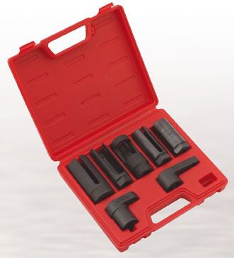

go to a renalut garage and have a look at their sockets, they are like a larger spark plug socket, with one side of the socket that swivels round, you can then fit it on, swivel the side back round and use it like a normal socket, also leaves the wire in tact
these ones, there are different types, but im sure these are the ones i used to change the o2 sensor on mine when i first got it
Hi Stella,
To be truthful four out of those six sockets are redundant bud, because there is no room to fit the extension bar into the top of the sockets!

not sure now if they are the correct one's i used, but saying that it was the one on the battery side that i replaced, my bro in law done it for me at the reg vardy renault garage and only took about an hour to change, they had all kinds of different wobbly extension bars that worked well, they use them for (i think) the renult espace v6 as its a nighmare to work on
I used a similar one to the ones in that kit. I used a sh*t load of force, but they wouldn't budge. The socket opened up and is still wrapped around my O2 sensor now!! I was going to fit divorced downpipes, but after this episode I gave up.
It all really depends on the quality of the socket, the one I posted up in the google search is the same socket that snap on sell and it does not open up and won't round the sensors off because it is six sided!
