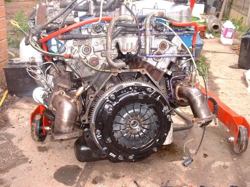

Not an engine out job just damn fiddly :( The problem is getting to the clamps really. Hose, used to get it from Smithy so try DTA or even MJP - Nissan won't have it. :)
There ya go - 2 hoses are marked by the red circles :)
cheers boss!
so if i replace those 2 (or is it 3 with the one at the bottom that looks a biatch to get to?) and jubilee them up tight enough i should be good to go?
Is there anything that can easily be moved to get better access?
Would the metal pipes i have boxed in blue or the rubber/silicon one in green not be the ones causing the problem? The steam is definitely coming from that right hand corner and you can hear the drip landing on the hot exhaust by the lambda sensor and evaporating. Well it must be more of a spray to start with to produce that much steam but quickly turns into a drip and the amount of steam subsides.
Thanks again for your help andy.
Sorry thought you'd said passenger side :wack: Yeah that hose is actually very easy to get to :) Better letting the car cool down then pressure testing the coolant system....
best news i have had all day! something that is dead easy to do on a zed!
Should i replace that hose in the green box with a silicon line or will a standard rubber one be good enough to take it another 100k miles?
What is that hose called or what does it do so i know how to explain it to smithy, danny or whoever?

i think you will find its the to water pipes on the back of the engine the two right up against bulkhead they are prone perishing and need replacing i think thats what your dripping problem is many thanks 300zxtubs
Thanks guy. Could you expalin to me exactly which pipes you are refering to, maybe you could use the picture andy posted on page 2 to highlight which ones you are talking about.
