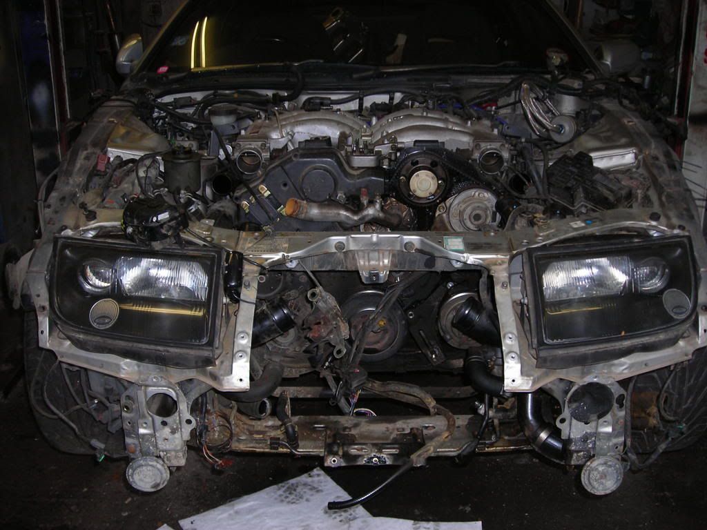

Picture of front bumper removed?
Ive searched untill my fingers hurt and I cant find a close up picture of a ZED without the front bumper, does anyone have one please?
I wanted to know what the tiny rad in front of the larger rad was for (right underneath the air filter) and also wanted to see the pulleys and which one is for what.

the 1" sq one is the Power Steering Cooler and the other is the engine oil cooler

this is my mate's TT...hope this can help ..;);)
wozza ..

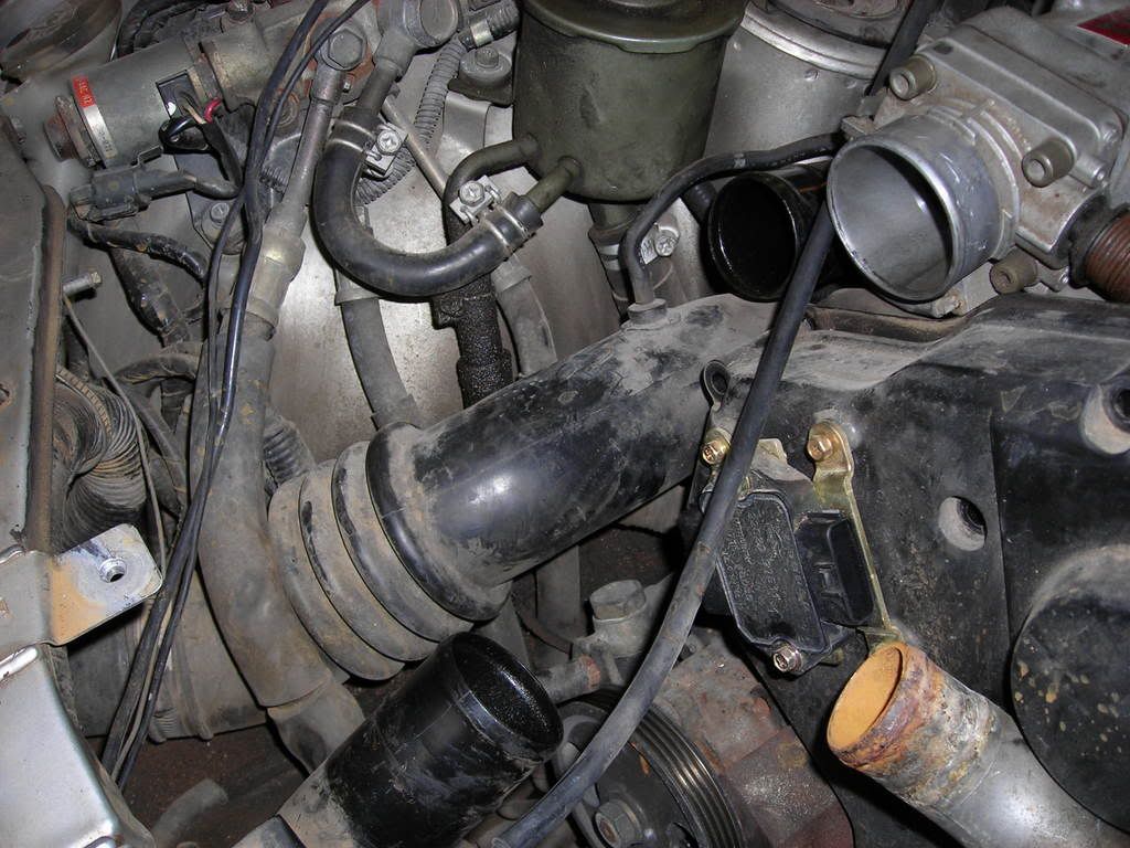

For a start it sounds as though a belt is loose, that would explain the high pitch squile. Im also inclined to go for the electric auxillery fan running constantly that would be the lower pitch mmmmmm noise as it sounds electric to me plus it is the only thing that can carry on running after the Engine is switched off, as already been said the plades are catching on something. To check, take off head light panel, this will expose air filter intk~instlld~2.JPG
You cant see it in the pic, but behind the filter you will see a black plastic fan, thats the aux fan, depending on what air filter you have you might be able to get your hand down to spin the fan to hear if it is catching, if not remove the air filter by loosening the 2 large jubilee clips (yellow arrows) either side of the T piece (pic) but first you will need to disconect the MAF square with blue dot in pic, but be carefull not to lose retaining clip. If you feel the fan catching, thats your problem, if not unplug the fan (grey connector down right hand side, i think) as it could be the motor. Replace air filter and connect MAF and start the engine if no noise when the fan isnt spinning your fan is fooked and its that what you can hear running all the time, which it shouldnt. Which means it could be the ECU temp sender is causing it and may need a good clean (pic below)
or it may be the aux fan relay is stuck (relay taken out in pic)
you can change fan felay over with head light relay to test it but you will need fan reconnected to see if it dont come on when engine running. Good luck wayne :D
