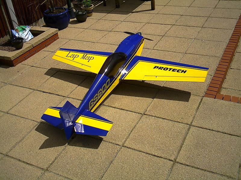

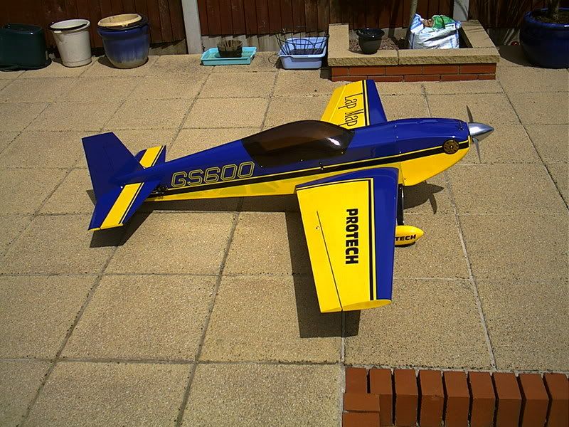

All this talk of models actually made me go in the workshop and clean this one up ready to sell , can,t fit it in my car , had a carlton estate before the zed :x:
It,s a 1/4 scale Protech Giles GS600 , 73inch span , fantastic plane but i,m more into funfly,s , sommat i can chuck around the sky and not worry if it hits terra firma :nono:

A nice looking model, Boldy, I've bought a second hand 72" wingspan 'custom designed' trainer model which is pretty robust (heavy) and a bit scruffy but it wasn't a lot of money and should hopefully see me through my early training days.
