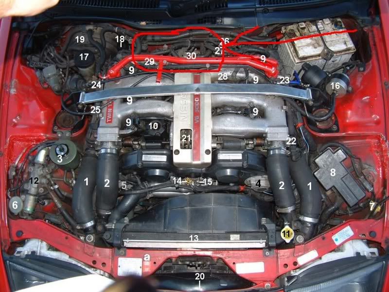

The only boost related pipes are off the red balance bar across the top of the engine. Check the small pipes are firmly on and not split.
Might be worth tightening the balance bar down and maybe checking/replacing the "O" ring seals under it.

Should be pretty easy to locate there.
Sorry should have mentioned that it is not coming from the top of the engine but behind and a bit down. Located somewhere near the heater matrix pipe work.
