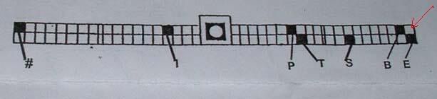

Afternoon all, Iv'e been searching round for the Ecu harness wiring this afternoon so far i have found all the pinouts i need but got 2 different diagrams showing 2 different ground wires.can anyone confirm wheather pinout(E) is the ground or the pinout above it with red arrow pointing to it.
I dont want to connnect switch on n it go pop so any help would be great thanks. :nana2:
The one marked E is the main earth, the one above it seems to be used for sensor earths...
Cheers Duffman op man. :dance: :)
