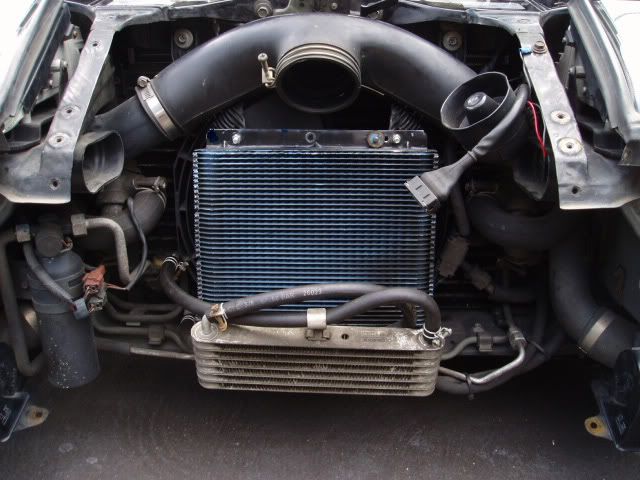

Here's a pic of my oil cooler.
What they say above, yes these cars need a cooler for the auto box. Mines an import and it was one of the first things I did this year after reading about it here and whilst I agree that the original cooler is next to useless, removing it completely does not make sense unless it is to fit a larger one. It's is a known issue and I think this should have been explained to you.
