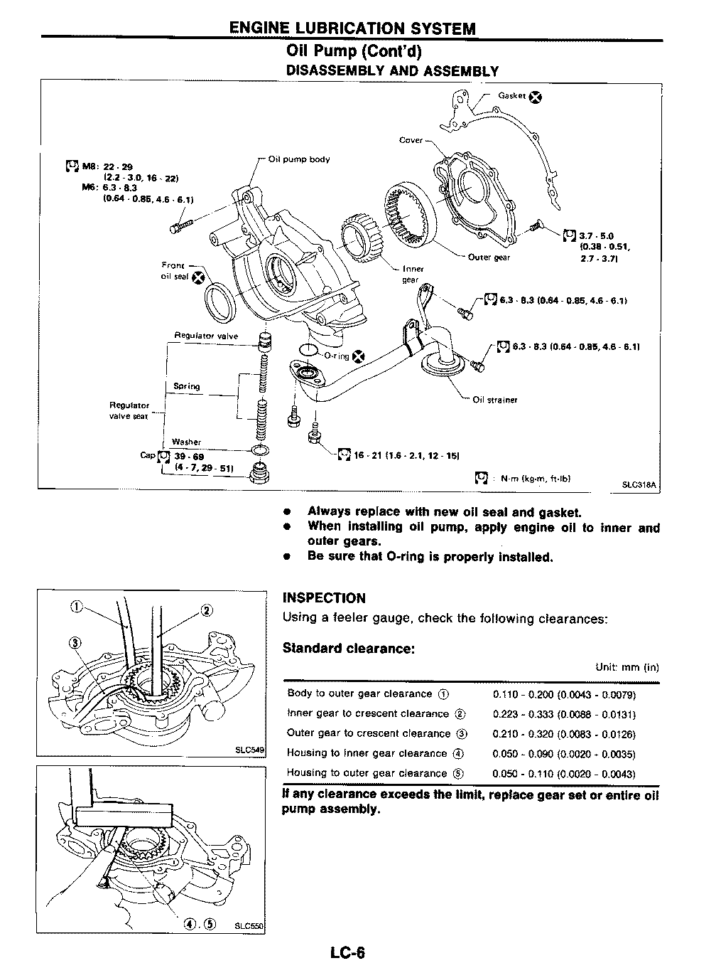

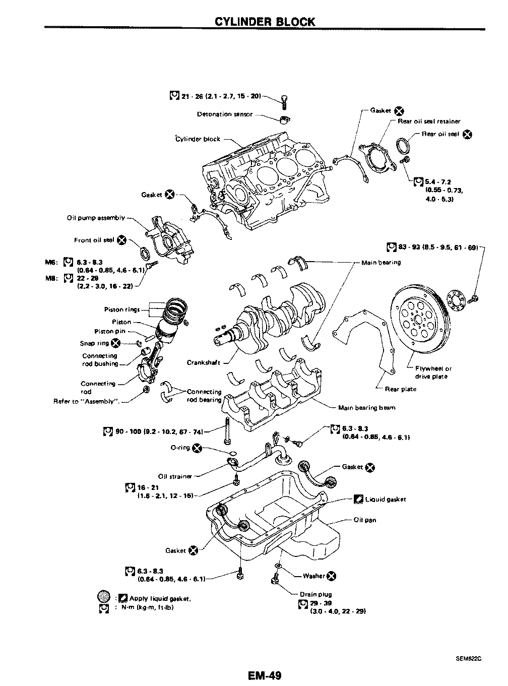

few pics for you,might be useful
BOTTOM END ASSEMBLY
OIL PUMP STRIP DOWN

Can you list the gaskets I need etc...
Obvioulsy I will need an oil pump.
But what else?
But what else?
make sure you have a good quality auto sealant idealy the black auto stuff you can get,i find red/blue instant gasket to be shit
sealant for sump,bead all the way around, including a blob under the corners of each rubber seal at front and rear of sump,and a film of sealant over the seals themselfs,obviously remove every trace of old sealant from sump face and block
check oil strainer o-ring and use a small film of sealant where it joins pump
oil pump gasket which will come with pump
oil return feeds from sump-turbo. new ones required idealy,check old but simple to replace.
crank oil seal which sits inbetween oil pump housing,shares the same name as cam oil seal there the same size
as your removing the cambelt you idealy need new cambelt and tensioner,and then you could argue is the waterpump due renewal as your there,but if moneys tight cambelt and tensioner will surfice
thats your lot as far as gaskets are required
HTH
