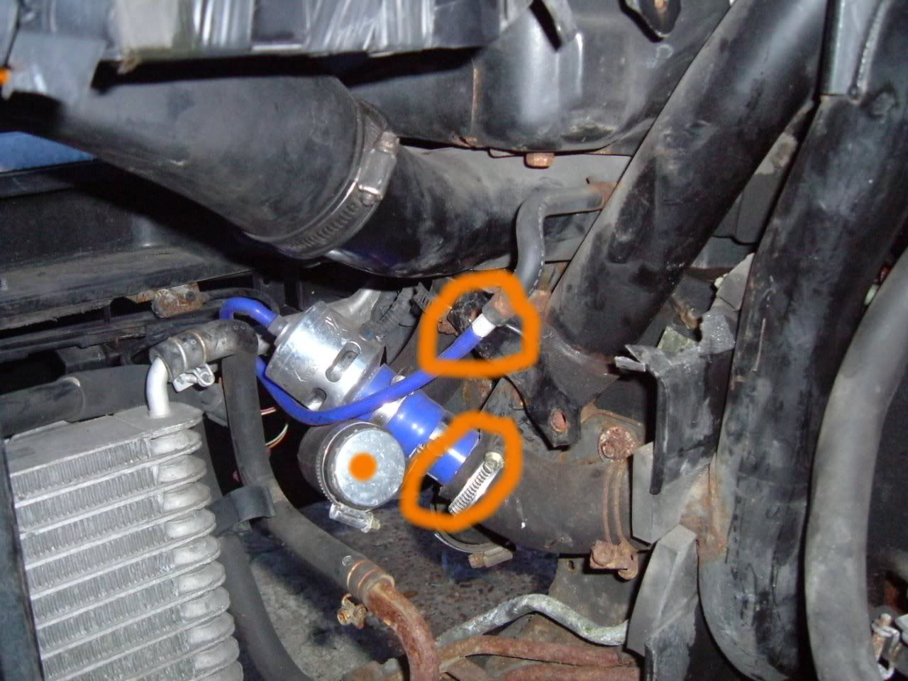

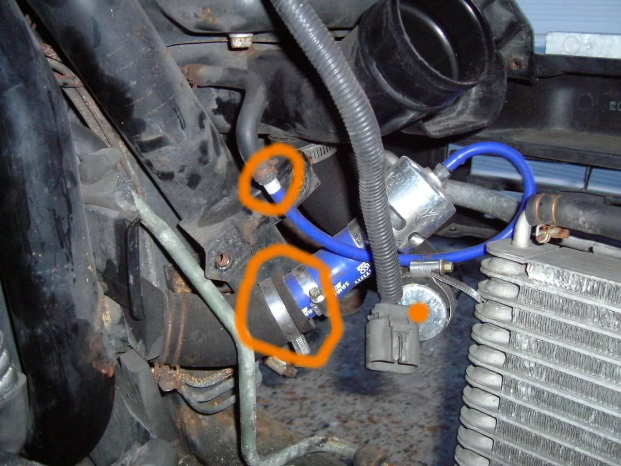

are they the baileys style ones(fit in place of the recircs, not on the hardpipes)??? if so have got a couple of pics, how it should look.

But you just take off the recircs, fit the BOV's and blank the other pipe with the rubber caps.
and
mine came with -
2 lengths of small silicone hose
2 short wide lengths of hose
2 little hose connectors
2 big hose connectors
2 blank caps
8 jubilee clips
(I know - great terminology!)
the ringed bits are where the connectors go and the orange dots are the blank caps.
lol - spot the uk car!
