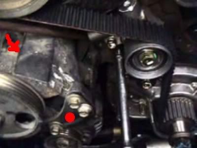

Crap pic alternator bolt is red dot,top of alternator if you stick your head down there you will see it,this wil enable you to move alternator side to side,once you have slackened 12mm bolt off loose

Cant find any pics like golddust
anyway arrow pointing inbetween pump and bracket lever inbetween and trust me it will move
doing that will probably move the pump further away! then by hand you should be able to pull it up to position required,if your careful to aid pulling the pump up sit lever bar between the main metal pipe coming from PS pump and this will pull it up just be careful to not strain the metal pipe
