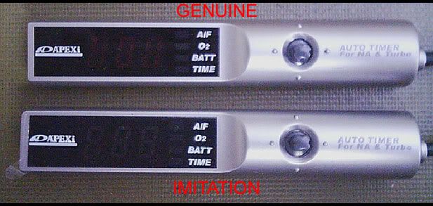

Following on from the thread about 555cc Nismo's ( I am not saying they are fake though ;) ) thought i'd post up a couple of pics showing just how clever some companies are copying Jap performance goods, Would you have spotted the difference if the pic didn't tell you ??? :eek:

I'll leave this running for a little while then show you how this was first noticed or if anyone knows how to spot the fake, do say ;)

the writing printed on the fake seems to be less clear then the original unless its the photo which has caused this.

Think that's the photo mate, however even if that was the way how to spot fakes, unless you bought a genuine one and a fake one, how would yer as a normal punter, know :eek:

its cause the bottom one still has the protective plastic film over the lens, look left bottom of bottom pic you will see the tab

Is it me or do they have different colour displays as well?? genuine being red and fake being green.

doh i was gonna leave it for a while longer to let the guys see just how impossible it is to spot fakes.

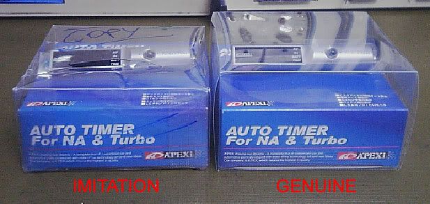

Heres the other obvious thing, however in the case of Chris's pic and mine, unless you know these goods inside out and buy sell em all the time, you the average punter, would never know :eek:
Thats what i thought , the display looks odd on the bottom one ???
Why would they go to all the trouble of copying the casing, components, pcb etc then get the size of the box wrong lol??
the imitation one has grey digits when switched off while the genuine is dark red. also the imitation shows the wrong A/F reading. and honestly ive not just read the link :D

Why does it say for NA and Turbo on both boxes???
Who the feck would fit a TURBO TIMER to an NA car?????
Because they monitor A/F ratios Voltages and cooling an NA down aint such a bad thing.
