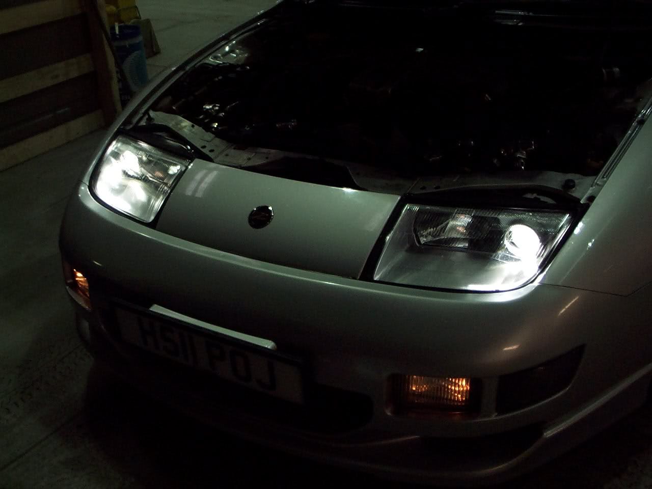

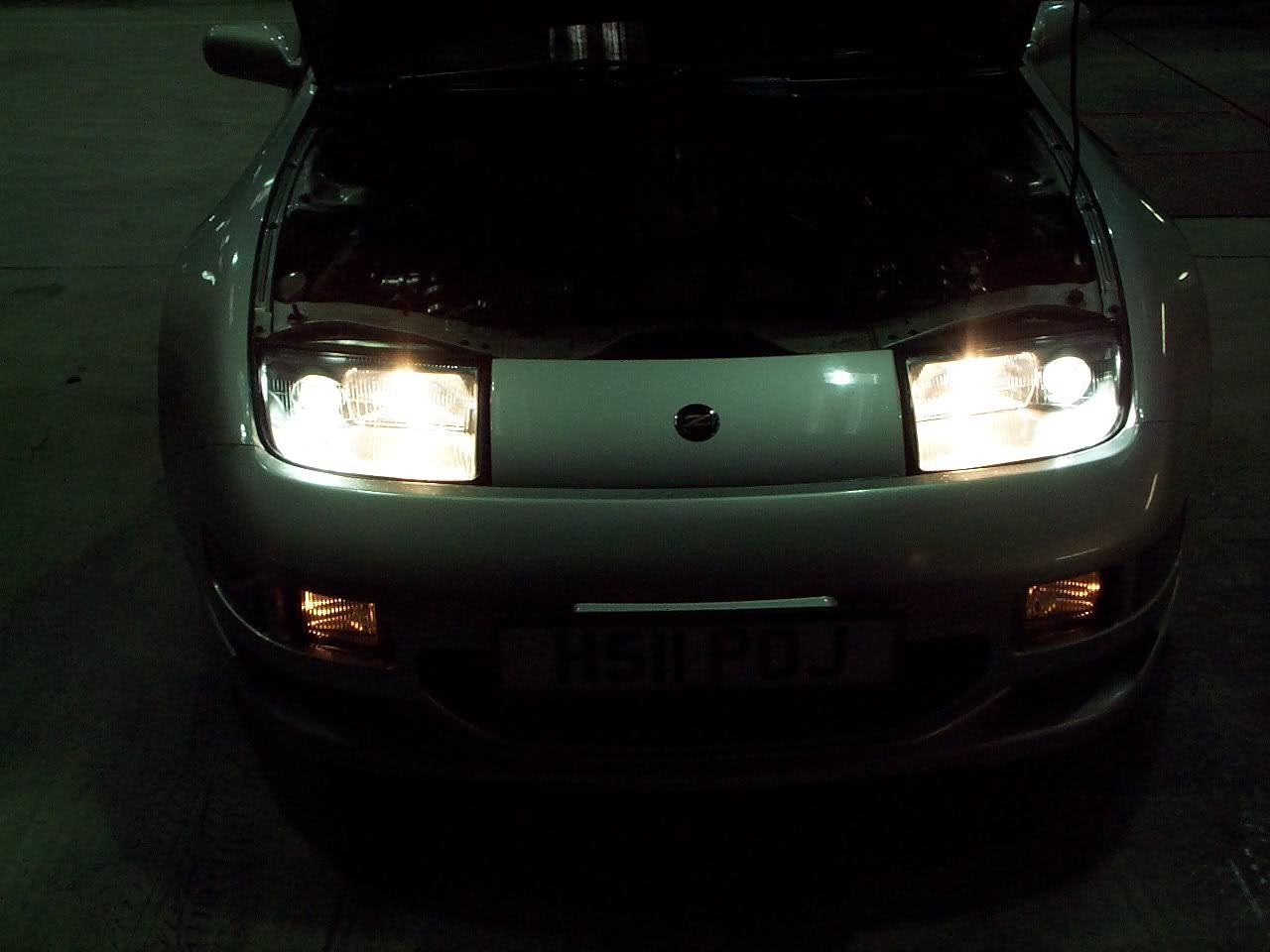

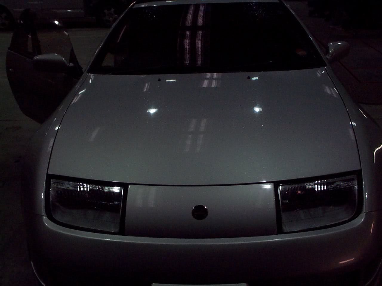

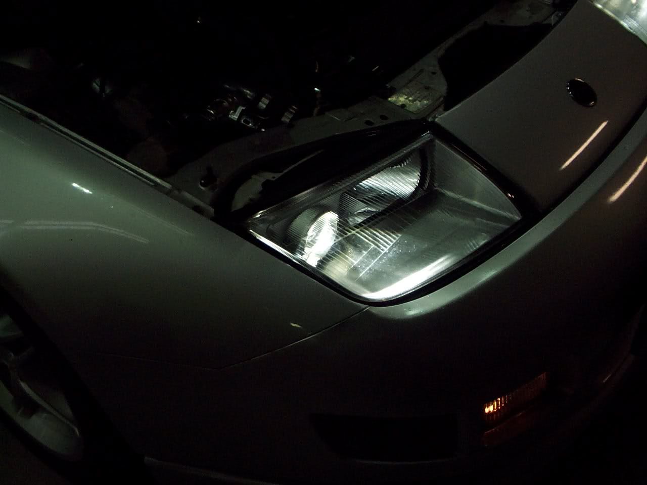

Sorry about the wait,but here they are.........
dipped lights......
ditto....
dip/main together..????
