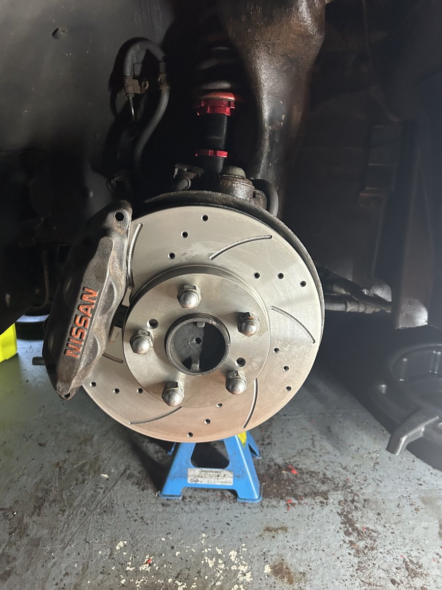

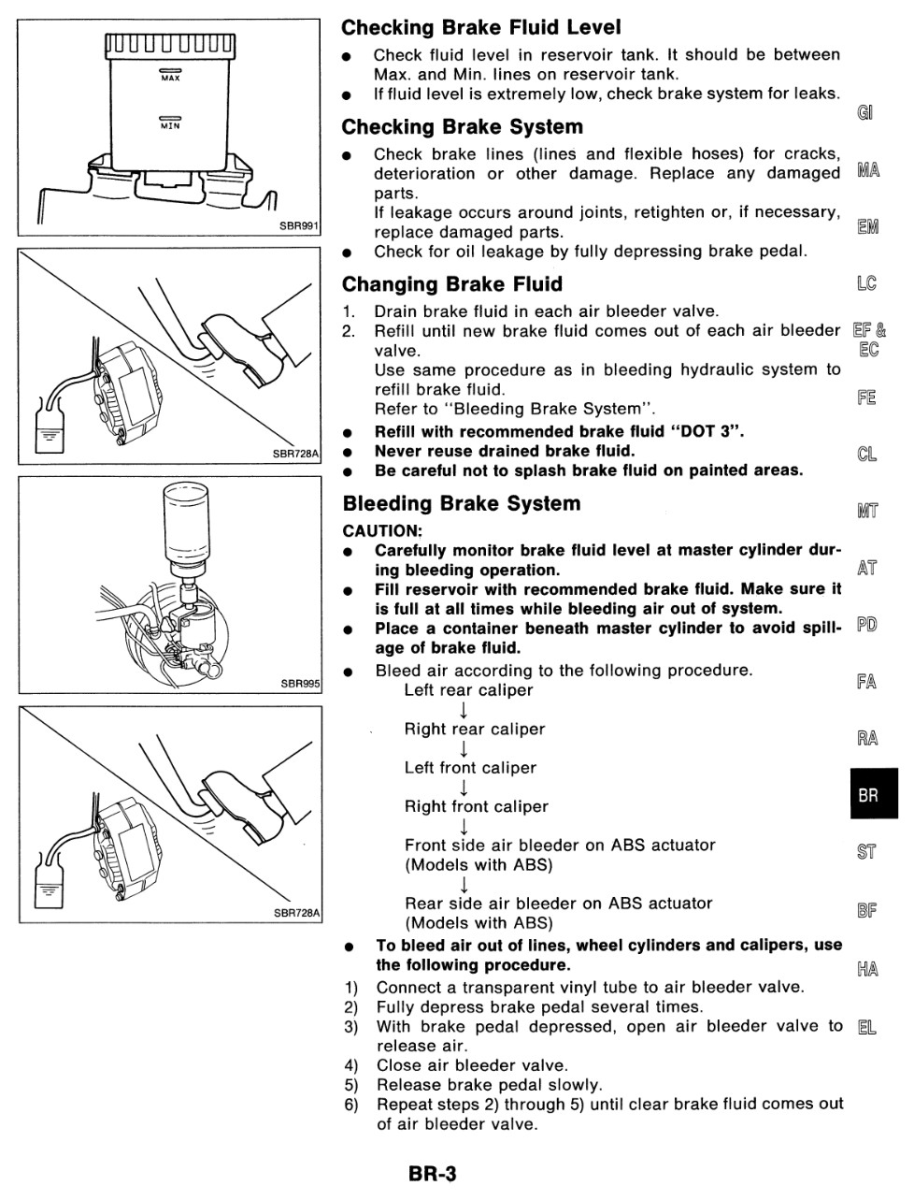

Need to bleed my brakes and read that after I do the calipers I need to do the ABS actuator.
Does anyone have a photo of the location?
Thanks

Fantastic! Thank you
