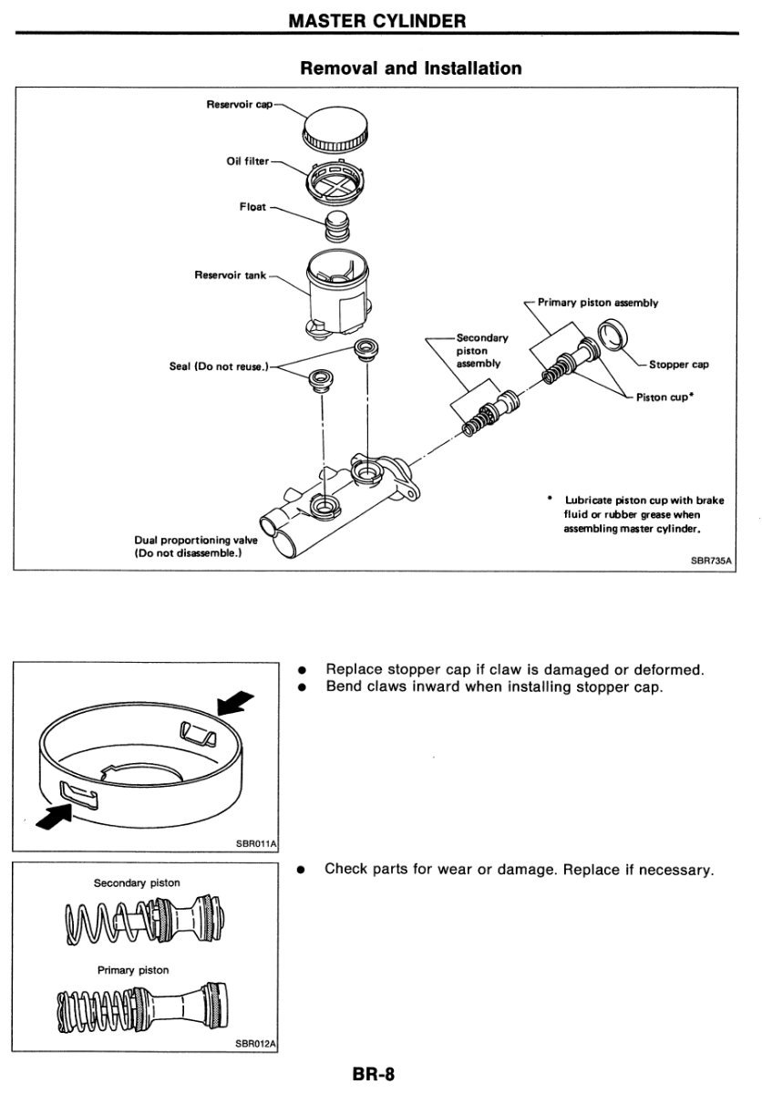

Can anyone explain how to take SNAP RING off end of bmc ?
And can it be reused afterwards ?
Solved by AndrewG
  • Solution
The snap ring (stopper cap in picture) comes as part of the refurb kit. The tabs can be prised back to release.

Many thanks Andrew, did not want to prise it off before i knew something about it.
I bought seal kit but no end stopper, hopefully it doesn't get damaged.ย
