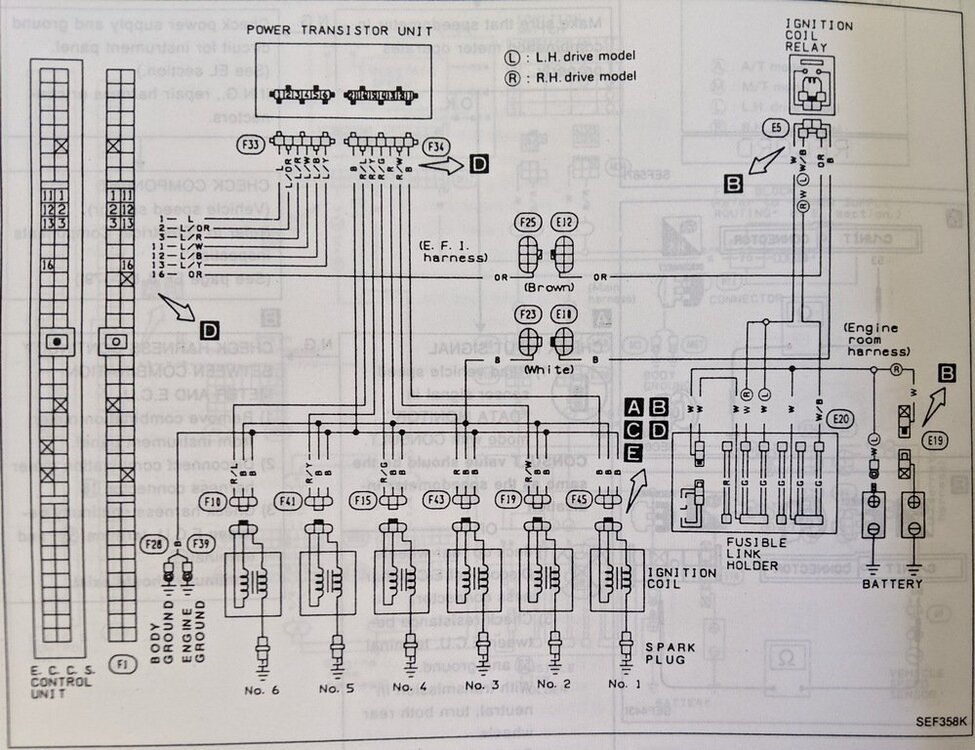

Hi guys, hoping someone has had this and can shed some extra light. i’ve traced a misfire back to 2x neighbouring cylinders both getting no spark. known working plugs and coil packs have been switched and swapped to test and it seems to be the coil pack loom. anyone experience this?

This is the wiring diagram for the ignition system if you need to trace back to the ECU. Also check that the ECU plug is properly seated, take it off and carefully plug back in.
Could be worth a continuity check as well in case a wire is broken

sorry its been while, just goot round to making a continuity tester. can anyone tell me if there is a way too check the signal coming out of the PTU? the ptu is a known working one removed from a running car but just wanted to be able to rule that out. thank you
