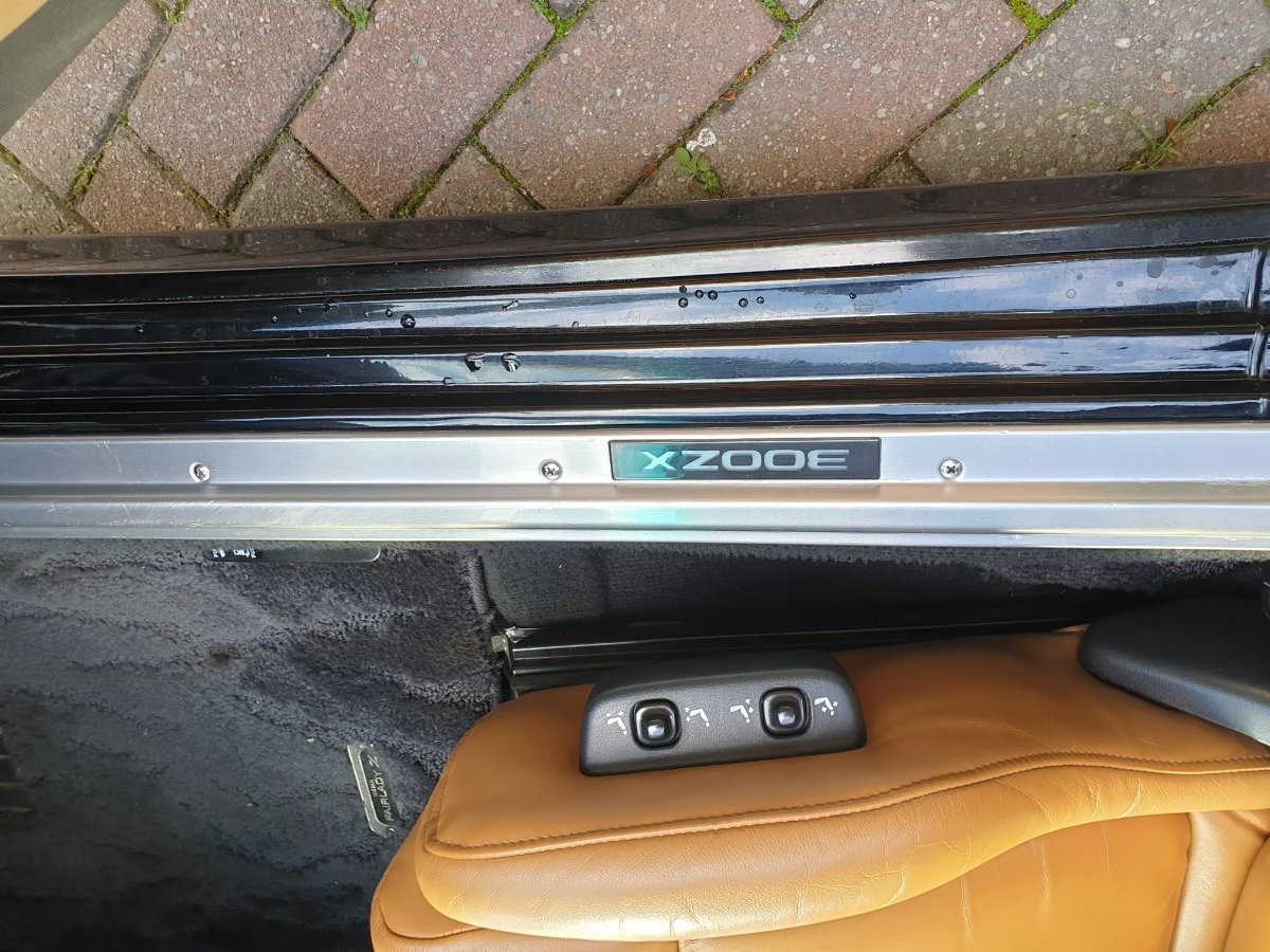

My car has the Altia sill plates...except they don't work. We've tested both sides whilst off the car.
Does anyone know the spec of the light strip if I wanted to try and replace them? Bonus if you know where I could source it from too!

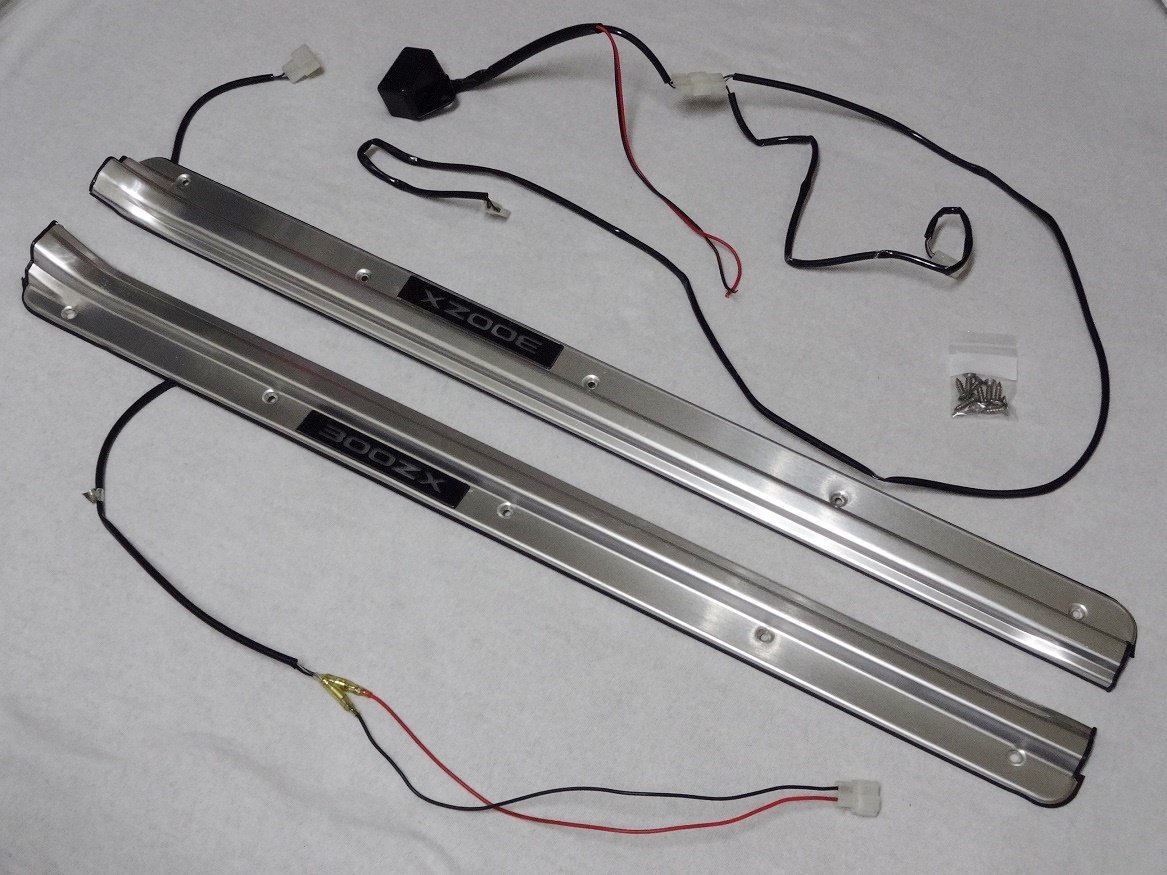

5 minutes ago, AndrewG said:
You have the invertor for the EL panels?ย  Black box below.
Presumable in the car but they're being bench tested by Brian Jnr at his shop. I neglected to tell him they need an inverter so will let him know tomorrow.
I've since found an answer to my question though, which seems like a very easy fix to get them looking as good as new. Nothing too surprising - EL strips which can be cut down to size. Worst case I'll replace original with these and get going.

Yeah you should be able to jut but one to fit.ย  Smithysplace used to sell them years ago but thats long gone sadly
