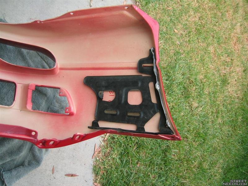

You will need to undo the engine undertray and intercooler duct/undertrays fixings at the front edge were they join the bumper lower edge. The parts
in the photos need to be transfered to from the '89 to the '99 spec bumper. The front support bar that hold the fog lamps are the same for both types.

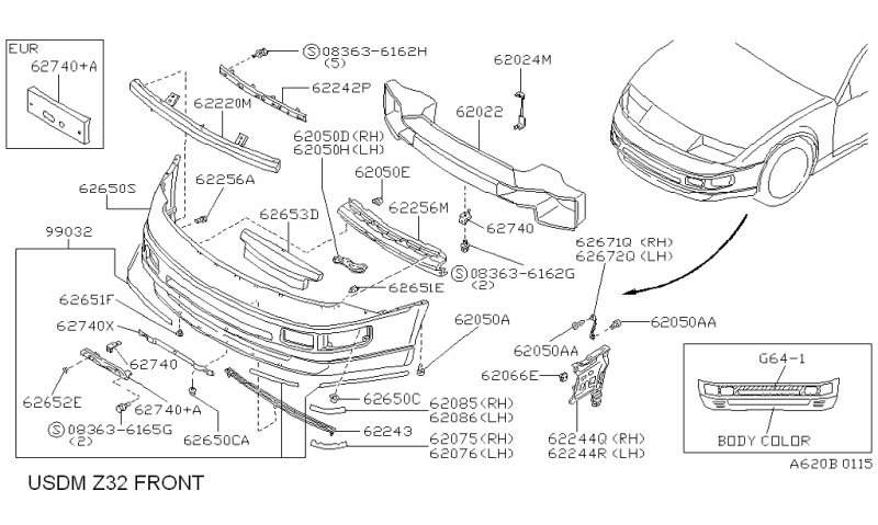

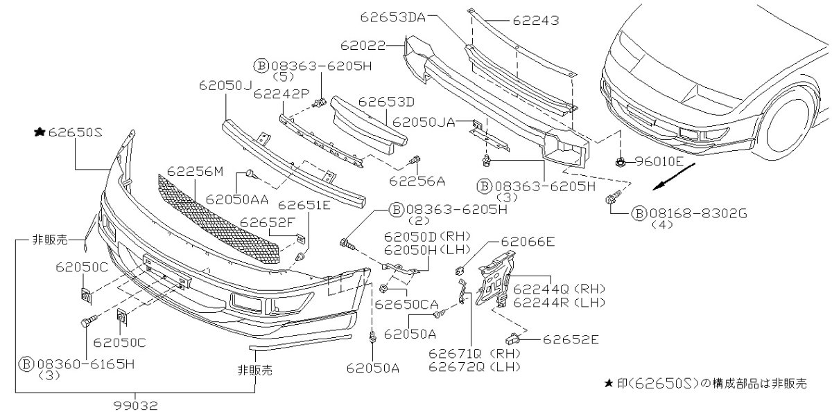

For reference these are the parts diagrams for the '89 and '99 spec bumpers.
USDMBumperPartsaa.jpg.2dfce389597bb7a0b3c431365c3d484f.jpgjspec_bumper_parts.thumb.jpg.e9c7828c56fb73f93659bc1835510ab6.jpg
