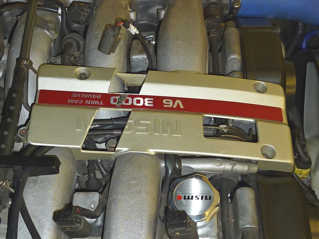

With the cover fixed in place I partially bolted down the strut and then traced two pencil lines on the cover where the
strut crossed. I then made up a wooden support to hold and fix the cover in place (using the four mounting points) in
a mitre saw and then cut across the cover to the required depth. The rest of the cutting was done with a fret saw and
finished off with files.

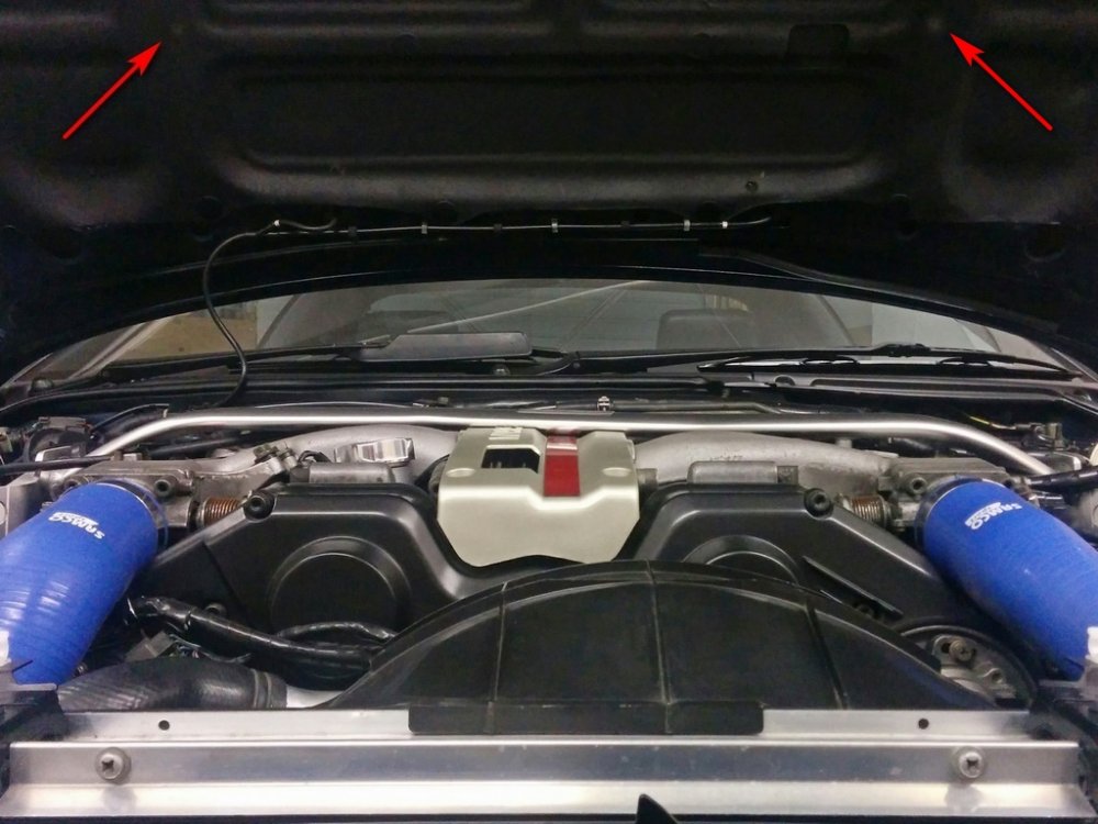

No, not really Andy. As it is the top of the Carbing strut rubs (very slightly) on the bonnet insulation (arrowed). It is very
tight in there.
When you see the strut in place in the engine bay, it is a pretty discreet piece of surgery on the cover.
