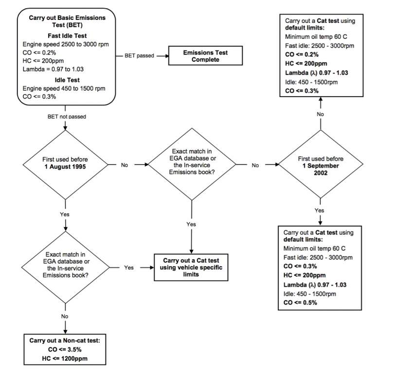

needed it to prove the manufacture date for upcoming MOT, using the table 1 flowchart i think you posted previously?
basically, anything up to 1995 M reg does not require cat test, and my tester is happy to accept that as long as he has proof, not just the fact it has M reg plate.
happy to use manufacture date as cannot prove first use date.
1995 N reg (1st August onwards) do require, according to the guidelines.
Haven't you got the date on any old MOTs ?
This is probably the flowchart. As you say 1st August '95 is the important date.
[ATTACH=CONFIG]118754[/ATTACH]
That's the one Andrew. I also found it in the official government manual.
Of the 3 import cars i have, 2 of them have first registered as the same date as when first registered in the uk. The other has a date similar to the manufactured date. So for imports, that field is fairly arbitrary.
If you can use the VIN to check manufacture date, then he is happy to use that as proof.
There has been no problem before with my blue zed and really wont be a problem now with the green, he will still test it with non cat test, but he has asked me if i can provide proof that he can store with his own records in case he ever needed it.
