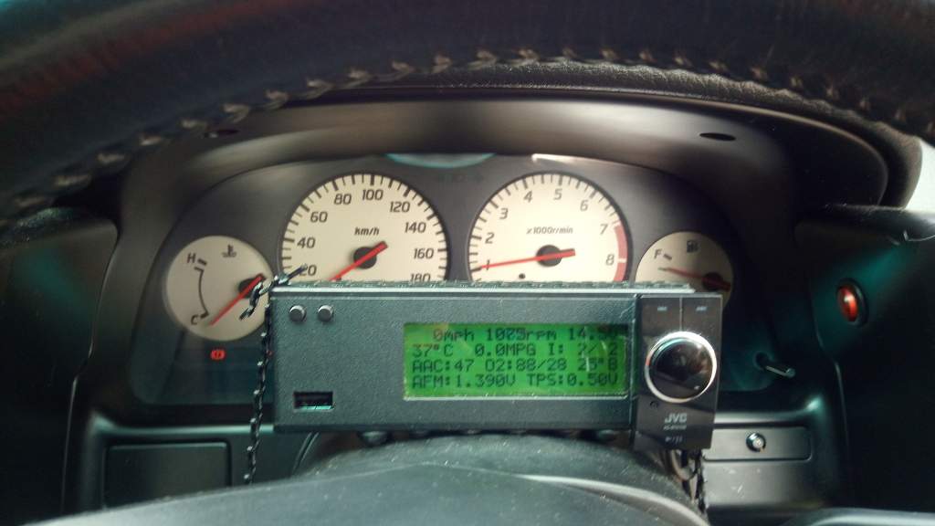

I used to have one of those big clunky ones from Ebay - sometimes it worked, sometimes not. I would go for something more like the Horsham Developments cable referenced above. Personally, I use one of these https://ecutalk.com.au/ which I put behind the wheel. Mainly because it also has a speedo on it so there's no need to do any other km/mph conversion, I leave the clocks as they are. IMG_20190319_112521.jpg
It does other stuff - mpg, trip, monitors a lot of sensors and has a USB interface you can plug a PC into and run other s/w like ConZult. The only issue I found is that (for a reason I don't know) ConZult can't read everything (some stuff works, some doesn't) but other s/w does. Couldn't track that down. Possibly because (I read somewhere) the later cars used OBD2 through the port but don't quote me on that.
Lymon (who pops up on here occasionally) was the original developer of ConZult so maybe he knows. http://300zx-twinturbo.com/
