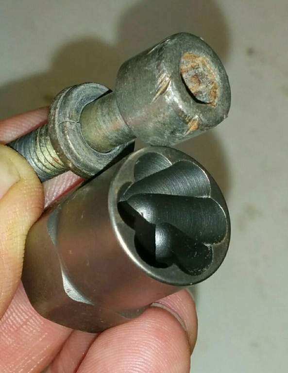

The offending bolts and the tool that will remove them if the 6mm hex socket in the bolt has failed:
The bolt head diameter is 13mm. The tool is case hardened and cuts into the bolt head and grips it as you turn
it counterclockwise. Just use a ratchet handle and push the tool firmly onto the head of the bolt and turn.

I use these never failed.

Will have to get myself a set for next time. Hopefully once they’ve been taken out they won’t be so bad
[ATTACH=CONFIG]116785[/ATTACH]
https://www.screwfix.com/p/erbauer-bolt-nut-remover-set-6-pieces/6083d
https://www.toolstation.com/irwin-bolt-grip-nut-remover-set/p63045
Loving these, not seen them before and look so simple. They might be helpful with an issue I have with the locking wheel nuts on my Skoda.
Have to ad to my collection as well.
