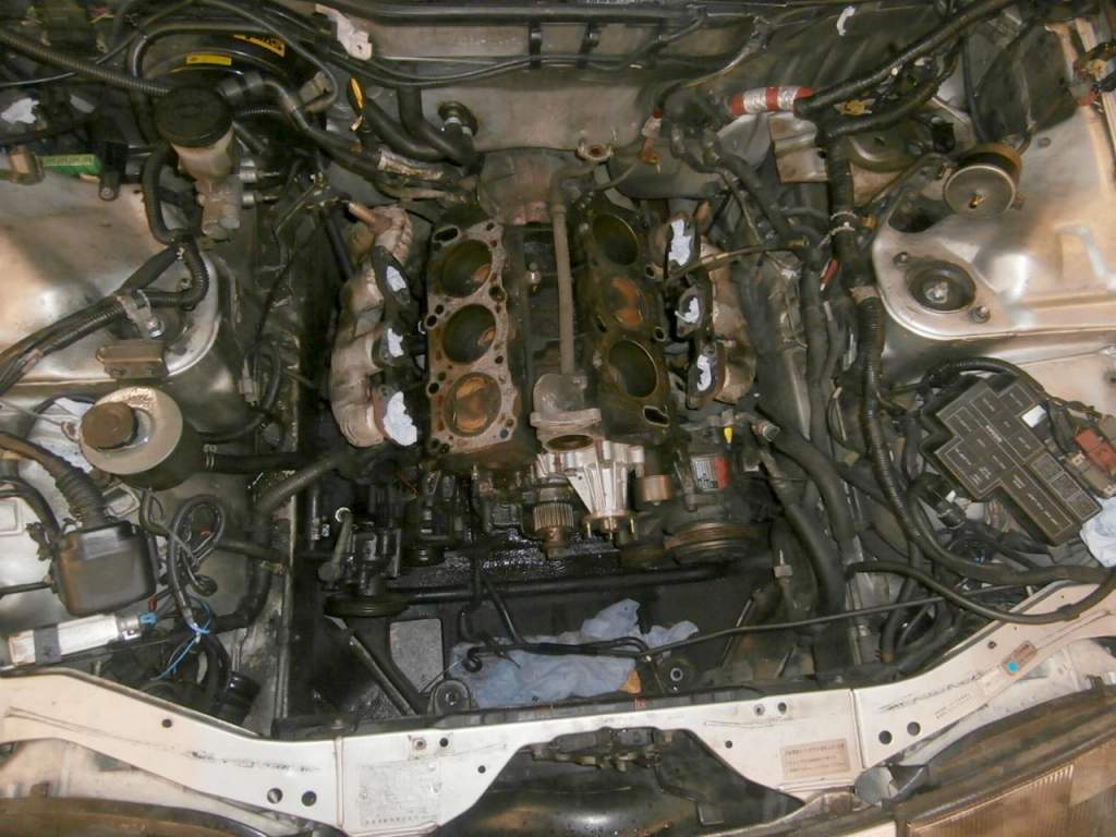

This is the level of stripping required, this however is a non turbo engine which is significantly easier in the car, but turbo can also be done.
Edited by JeffTT

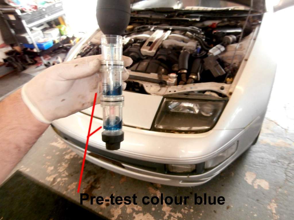

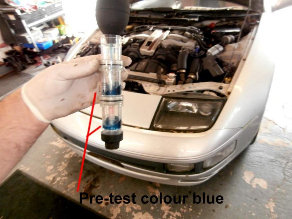

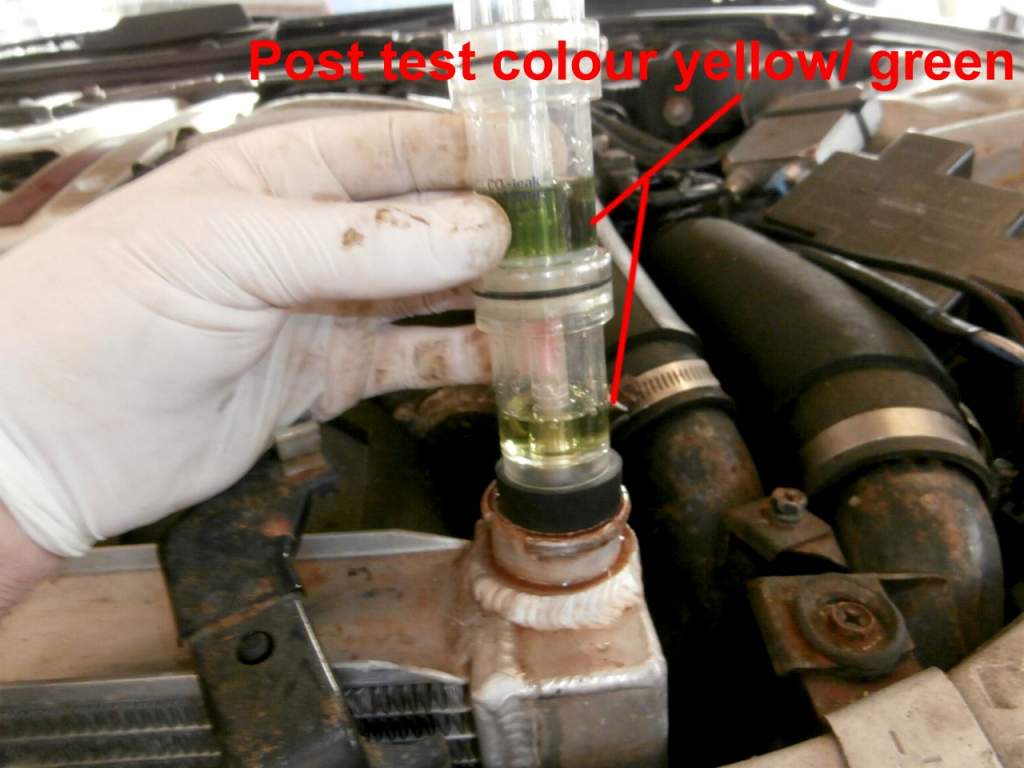

Get a test done like this first >>
