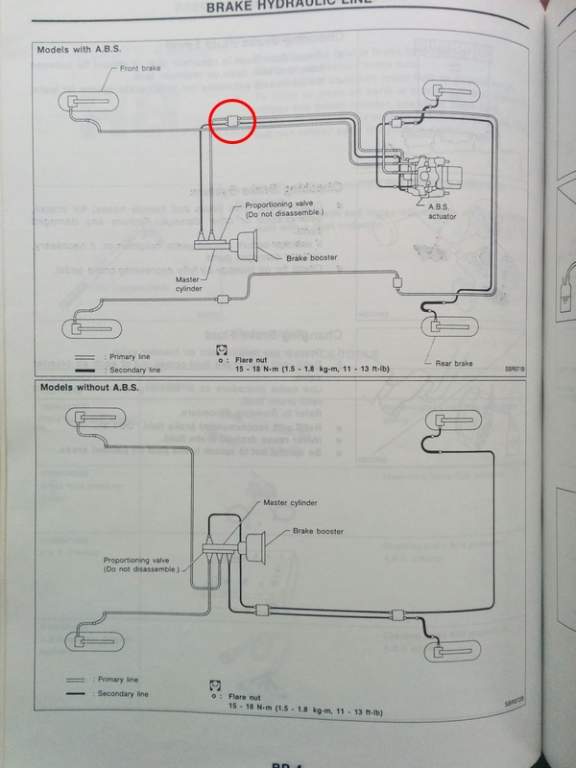

Having a problem with the brakes on Z32 300zx SWB, there is a awful lot of pedal travel, I have checked the free play adjustment on the pedal and while checking brake pipes and calipers for leaks I have noticed that on this car the brake pipes from the master cylinder on the o/s front there is only one brake pipe going through the o/s wheel arch whereas on inspecting another 300zx Z32, there are two brake pipes going through to the wheel arch and they go to a small block bolted to the inner wheel arch, which is missing on my SWB can anyone tell me what this block is and what it does
My car appears to have the facility to fit this block as there are two mounting holes in the inner wing under the wheel arch

If your car is an NA and not fitted with ABS then you won't have that block as it is part of the ABS pipework. For a car without ABS
you will only have one pipe coming through to the wing from the master cylinder. The diagram below shows the lines and blocks:
http://nissan4u.com/parts/300zx/er_z32/1993_3/type_1/brake/brake_piping_and_control/illustration_1/ (parts diagram for TT with ABS item 22)

Take a look at the brake master cylinder - cars without ABS have three hydraulic lines and ABS cars have two hydraulic hardlines connected
to it. You can also check by looking behind the body trim behind drivers side seat - there will be an ABS actuator if the car has ABS. There
will be an "Anti-Lock" light on the dash (which comes on briefly when the car is started) and normally an ABS sticker on the brake booster
for cars with fitted with ABS.
