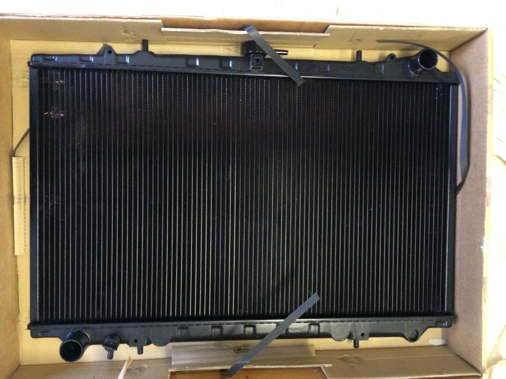

N/A Radiator
Are there any differences with n/a auto and n/a manual radiators

no idea, sorry.
this came with a few other bits and pieces i was sent, didnt know it was N/A until it arrived.

As far as I know, the auto radiators have separate cooling chambers for the auto transmission fluid. Certainly the TT version does - and the UK-spec is different to the J-spec. However if you do have an auto - and need the additional fluid cooling facility, a simple after-market oil cooler and extension hoses are not expensive purchases!
