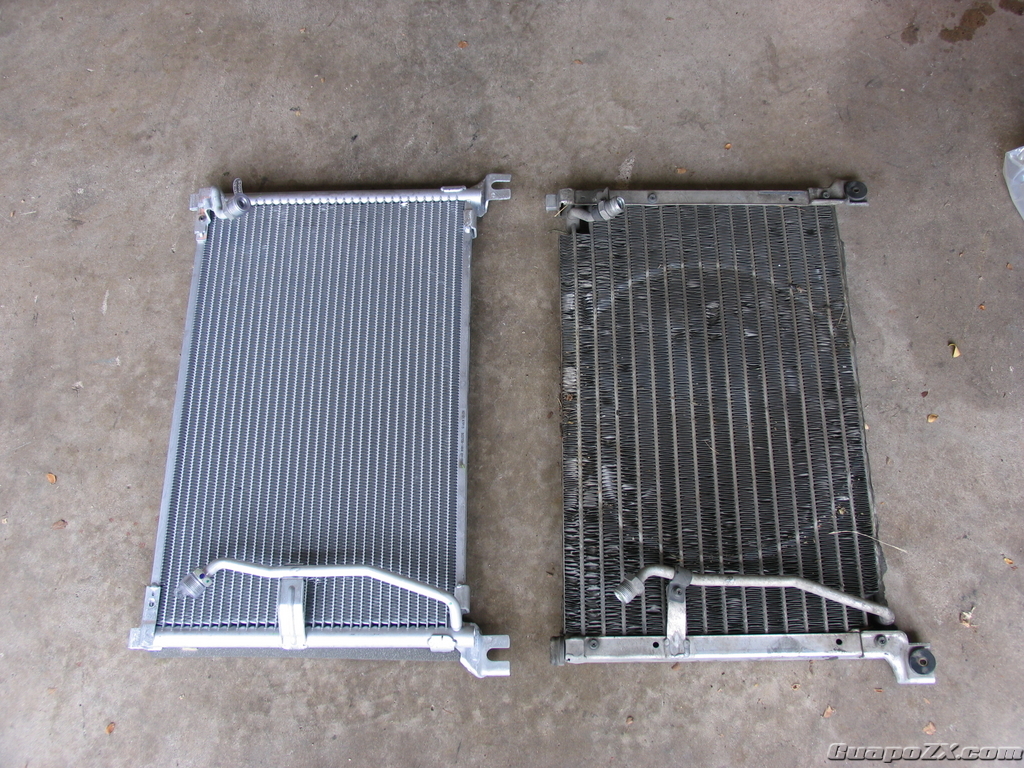

94+ on the left 89-93 on the right

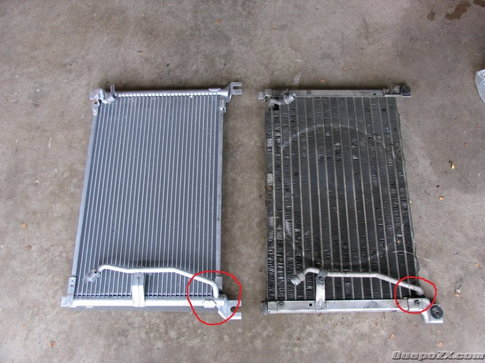

lol yeah took me a while the main 1 is the pipe fitting i've ringed it in red
