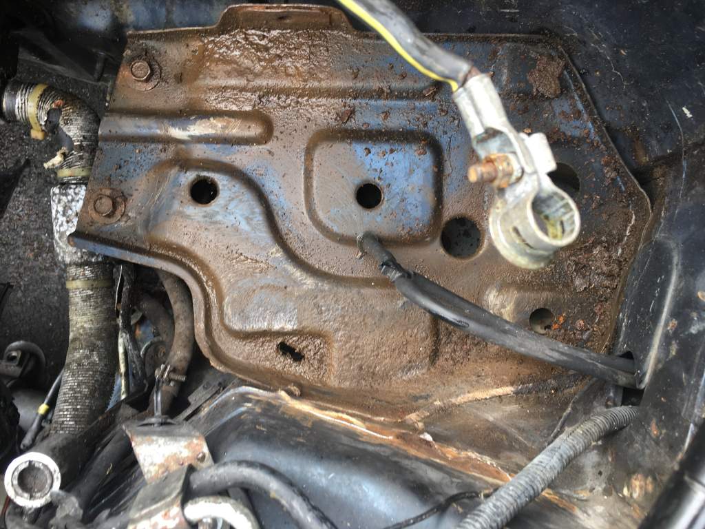

Gaz, I'm interested in tidying up the engine bay, I want it as clutter free as possible, also the batteries over the years have started to corrode both the undertray and the strut tower, so I'm at it as we speak with a wire brush and then will be treating the area with Loctite Rust Remedy. Now that the engine is out and I've no time constraints to finish it quickly, I feel the best thing to do is tidy up everything as best I can.:thumbup1:
I should have done a before pic as it was crusted with rust:thumbdown:
