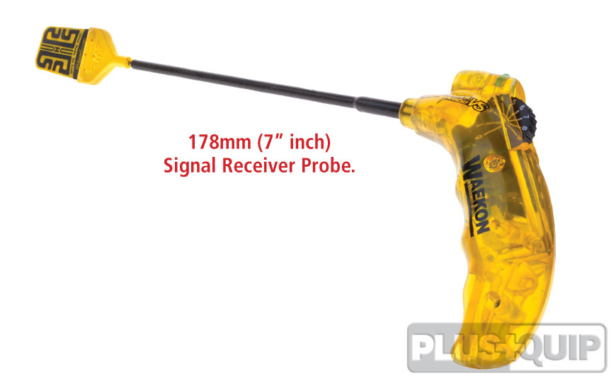

To safe all that faf in the future get one of these, brilliant just touch by the coil pack and it not only tells you if the coil is triggering also if the plug is firing and how well, would not be without mine, works on any car with coil packs.
