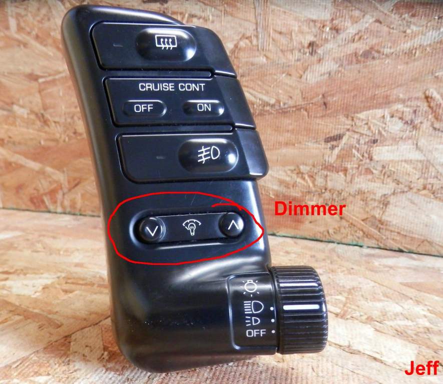

As for the lack of instrument lights that was just me being an idiot! They work but were too dim to be seen properly in daylight!
Make sure the dimmer switch is not on low setting.
Jeff
