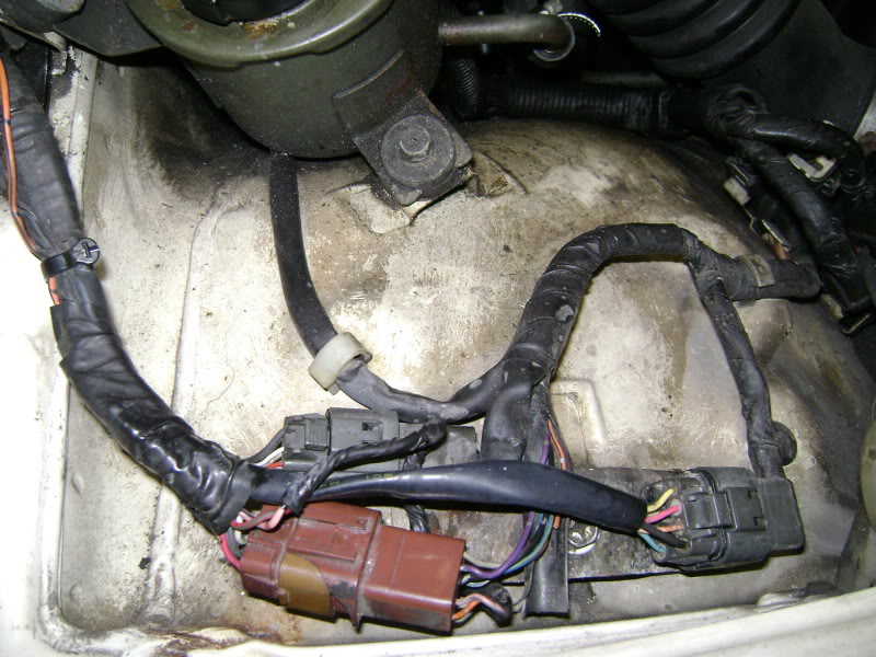

Have you checked and cleaned connectors for the auto box?
Here's a picture of them.... Check they aren't green and corroded and snuggly fitted together.

Will check the connections, how would i test the tps?

I've looked at the loom and everything seems fine, including the TPS.
So it looks like I'm definitely looking for a box now, got cash waiting lads.
