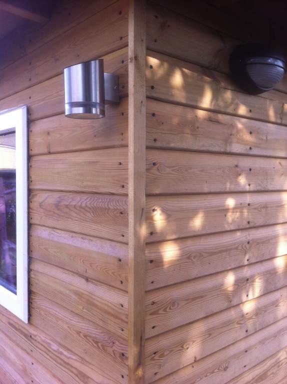

Had the next delivery so spent a few days off work getting the outside about finished. A few little bits to do to finish around the windows, fit the corner trims pieces, etc but looking very much like a garden office.
I've built a matching gate and closed off the side as well. Just the roof to finish and then onto the interior....
Looking good mate, i used some timber to give me a finished edge, might be worth you looking at if youve only screwed the cladding on:thumbup1:
I've built the corners so there's room for a 30mm x 30mm timber to cover the ends. I haven't fitted them yet as i've got to decide on a finish for the wood yet and paint the hidden bits - already ahead of you buddy :D
Thanks Richard :)
