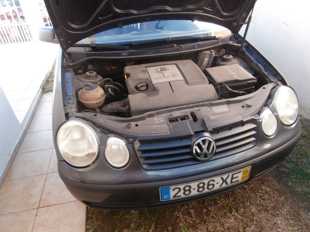

So walking the dog in the Sunshine and the distinct sound of a misfiring engine came up the hill, the car in question a VW polo 1.2 was struggling to make it up the incline and as it struggled to passed me, I saw it was a local from a neighbouring property.
Now for those that do not know the 1.2 Polo is a three cylinder engine so with obviously one not working it was struggling on just two which is some feat in itself!

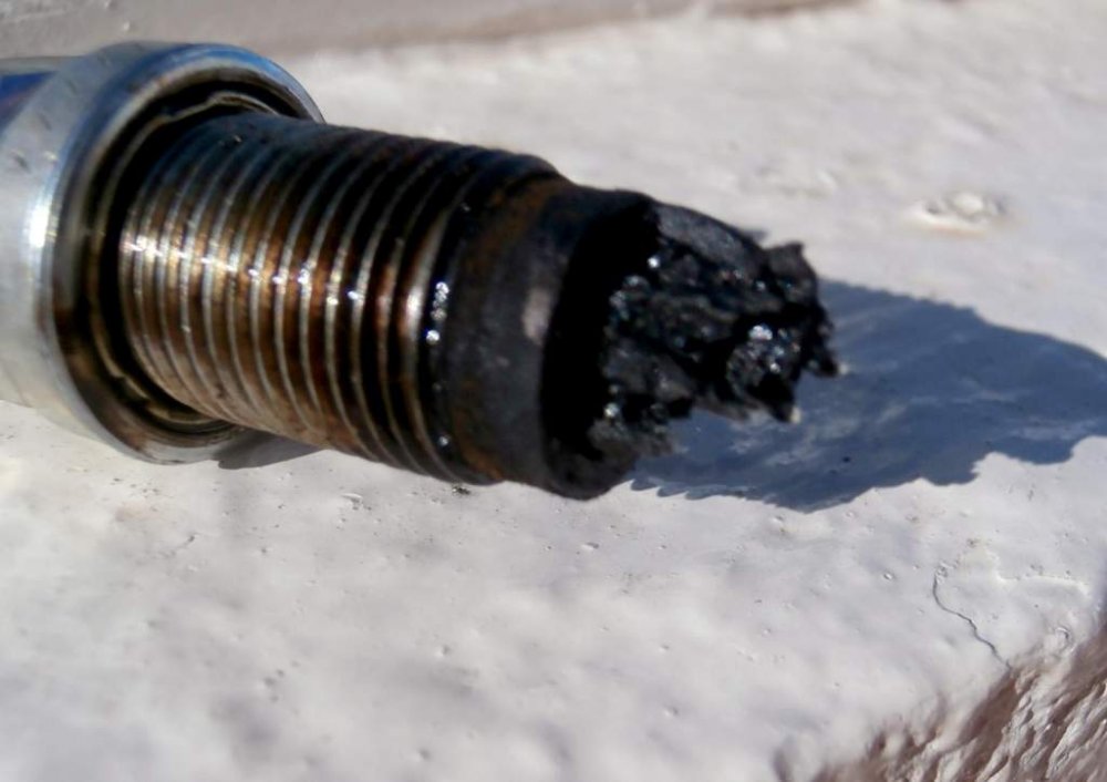

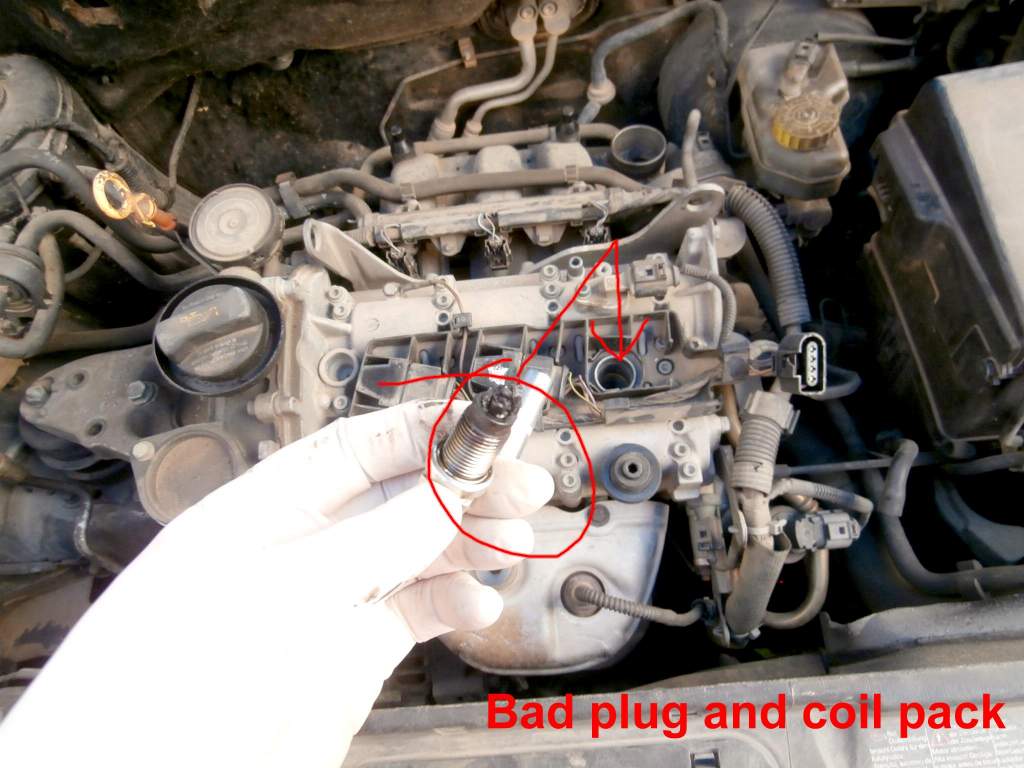

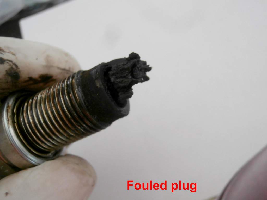

I popped around and suggested we have a look and low and behold a failed coil pack on the back cylinder so no mystery there then, but the plug on that cylinder was a shock to see, the amount of crude built up as it not been firing was amazing.
A new coil pack, full set of plugs and the little 1.2 was soon running ok again, amazingly the owner had put up with for 2 months thinking it was something much worse and expected to be paying out big Euro`s !!
