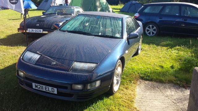

Finally work is about to begin on the Slicky
Well the extension is finally finished (ish), although the workshop isn't fully sorted yet.
I've spent the past 18 months collecting parts for the car and will be starting work on her once I'm home in 2 weeks.
Work to do -

Nice looking car Lexx and a nice little to do list, looking forward to reading up on this:yes:
