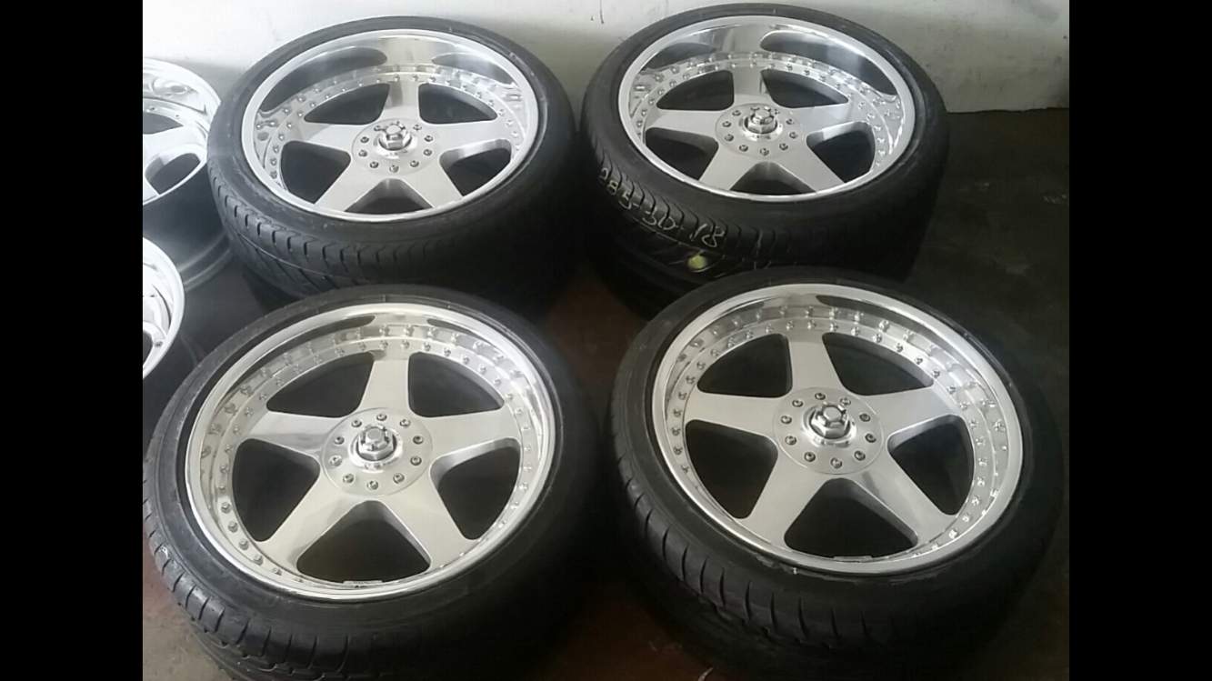

Just this minute been told that the wheels are fully finished and the tyres are fitted:hyper::hyper::dance:
They look absolutely gorgeous! You must be chuffed to bits.
Great stuff Richie
Thanks guys, I'm well chuffed to see the final finished product, BIG THANKS to Brendan at Team Chihuahua for doing them for me:bow::bow: The guy is truly talented:thumbup:

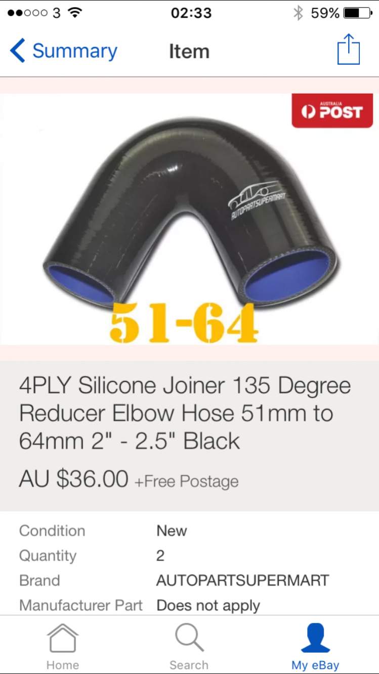

Also ordered some 130 degree 2.5"-2" reducing elbows for the Selin kit, made an offer of $36 AUS (€24) for a pair of 4ply ones that look capable, delivered to the door, will be here by March 7th, I'll let you know how they work out:thumbup:

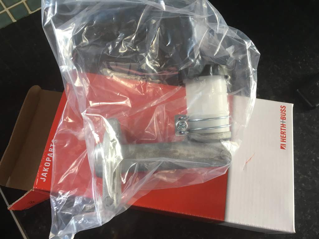

Clutch Master cylinder should be here today or tomorrow and I've located a centre section for the exhaust, hoping to have that by next week, so fingers crossed she will be finished mechanically by the week after:punk:
So my Clutch Master Cylinder arrived, hopefully getting it fitted over the coming days:thumbup:

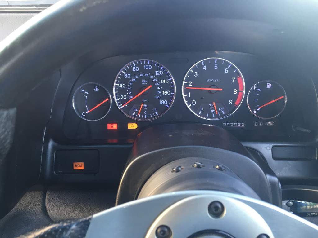

Didn't get the clutch master done today (both lifts in use). So I decided as it was dry today that I'd work outside the garage, Fitted my UK spec clocks and my Momo Race steering wheel:thumbup:

Got any pics of this uprated interior?
Have a vid if I can get it to work... Forgot to get a decent pic of the Momo:oops:
