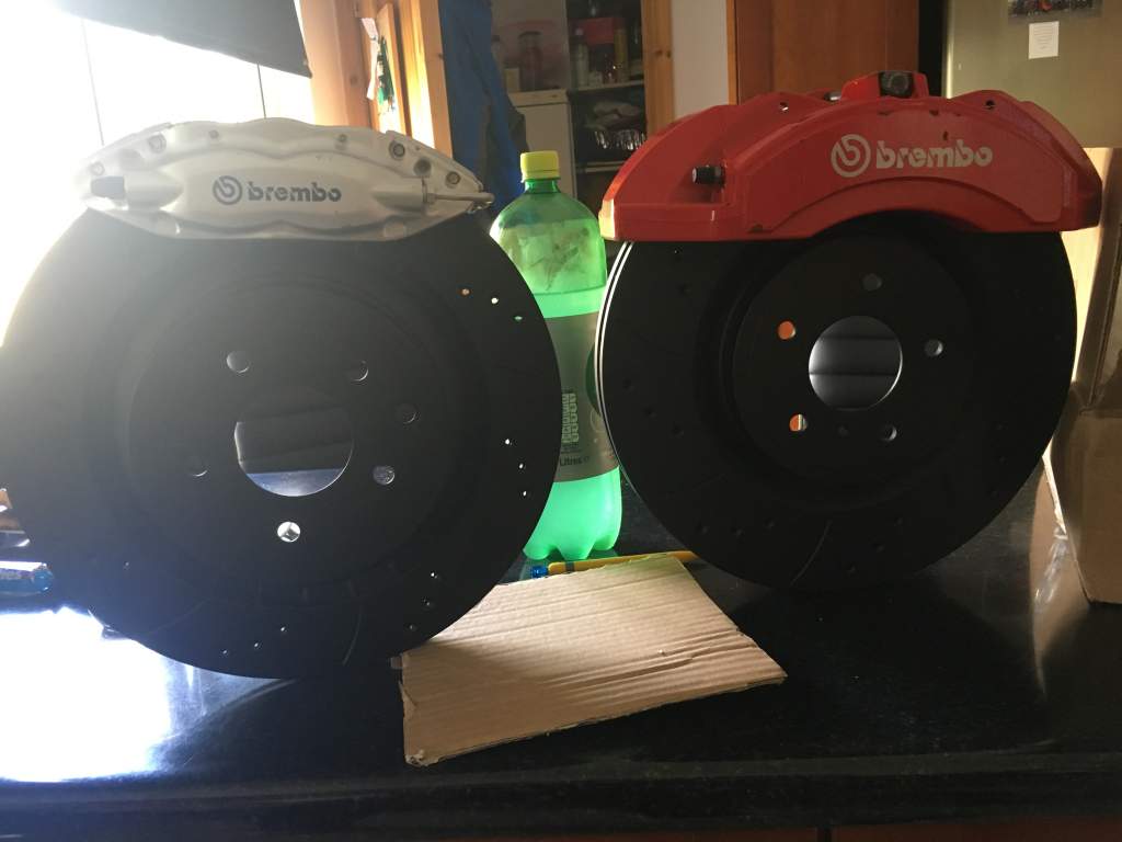

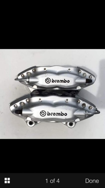

So, my excitement soon dwindled over these, the rears don't fit a Z32, they fit Supra's and 350z's:no:
I was well chuffed with them as they were brand new with brand new Brembo pads:thumbdown:
So it's back to the drawing board for my monster brake project:whistling:

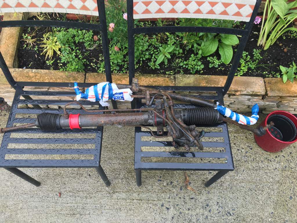

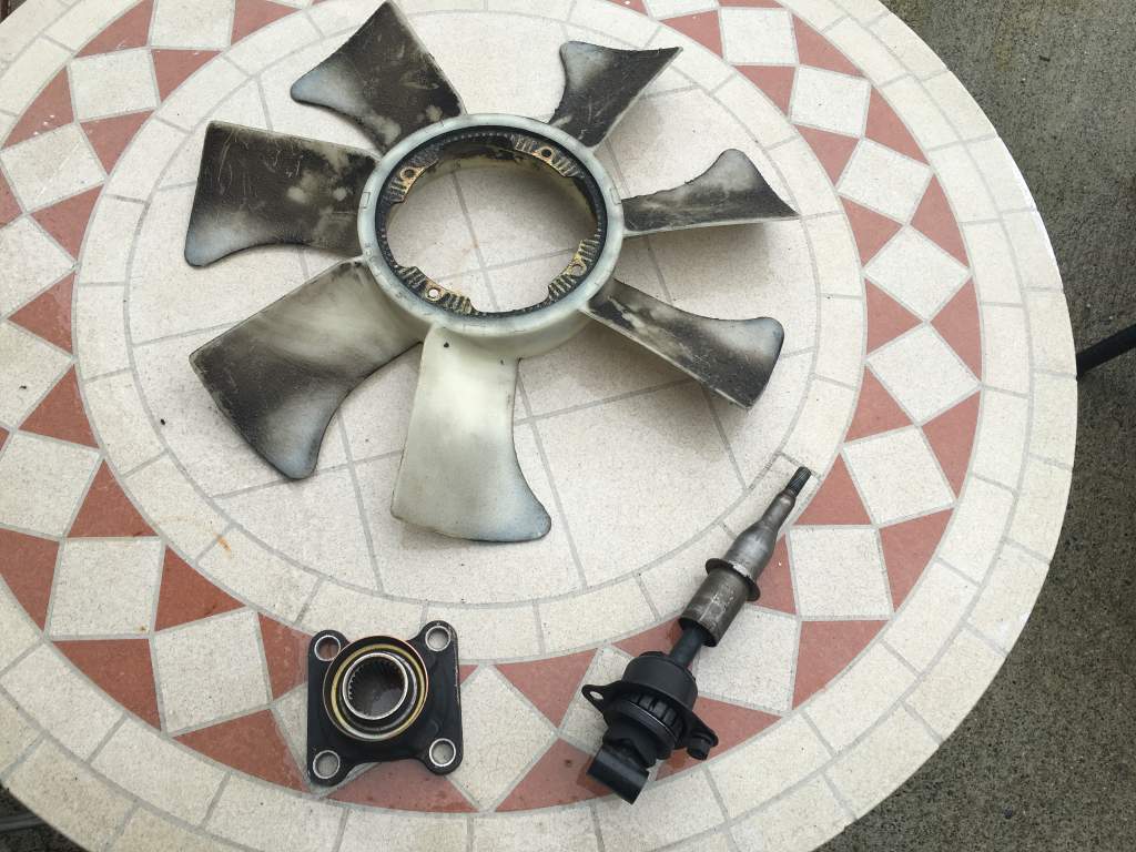

Fan, power steering rack with poly bushes, prop flange and OEM shifter (already have bronze bushings for it)

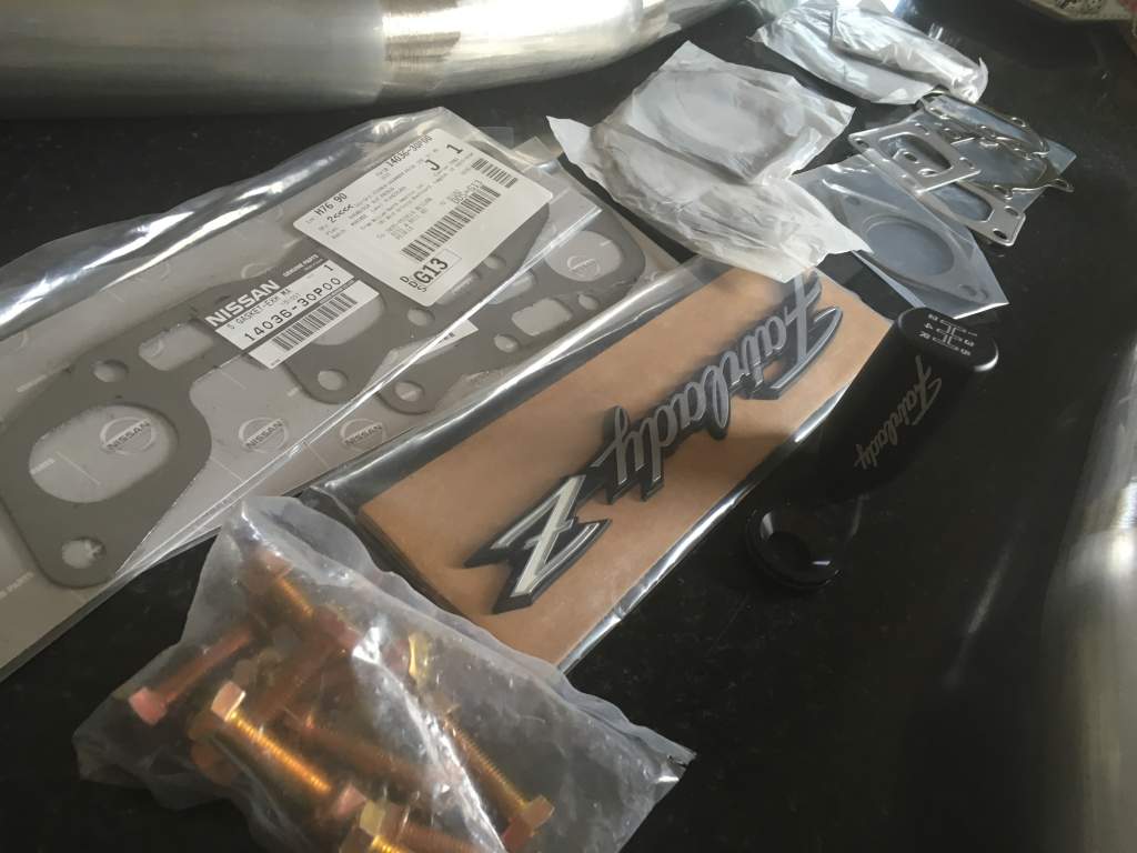

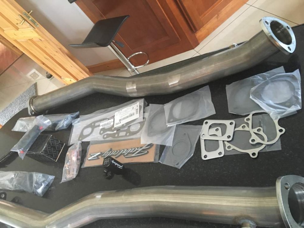

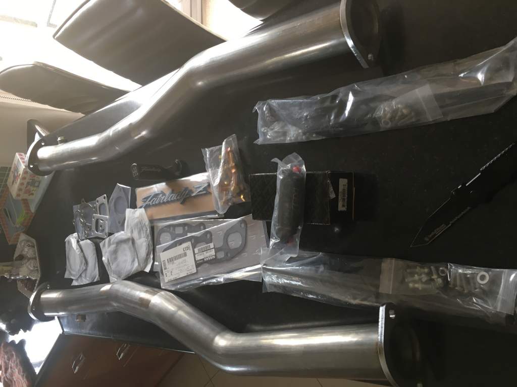

Another great day today, more goodies arrived for me (3" Z1 testpipes, AEM 320lph pump, mani gaskets, turbo gaskets and my Win factory bonnet struts), for Phutumsch (Win factory bonnet struts) and for Evaansss (FairladyZ emblem and gear knob):punk:
All I need now is my 3" divorced downpipes, which should be here in the next fortnight or so:thumbup1: then I'm ready to start building up my engine upgrade :punk:

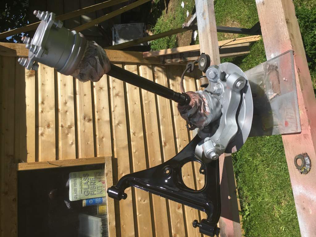

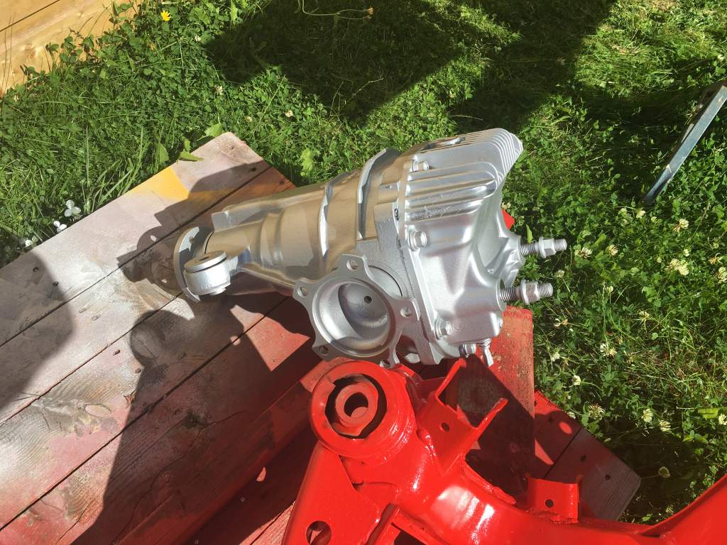

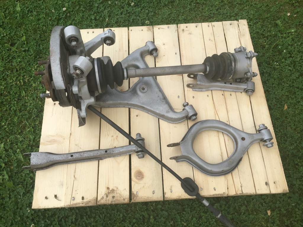

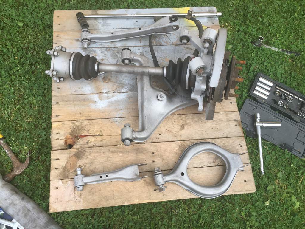

Got out to the garden today and got stuck into the NA subframe again :thumbup:
After shot blast
After a tidy up
Diff done :yes:
Leaving everything to cure till Monday, when I will begin reassembling the rear

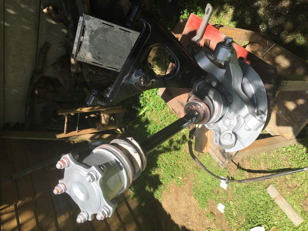

Change of plans on the subframe assembly, I've decided that while it's all in pieces that I'd get new Energy Suspension Diff and drop link bushings, they're on the way, also ordered my 355mm front and 350mm rear brake discs with the change I had from selling the rear 4pot Brembo's. :thumbup:

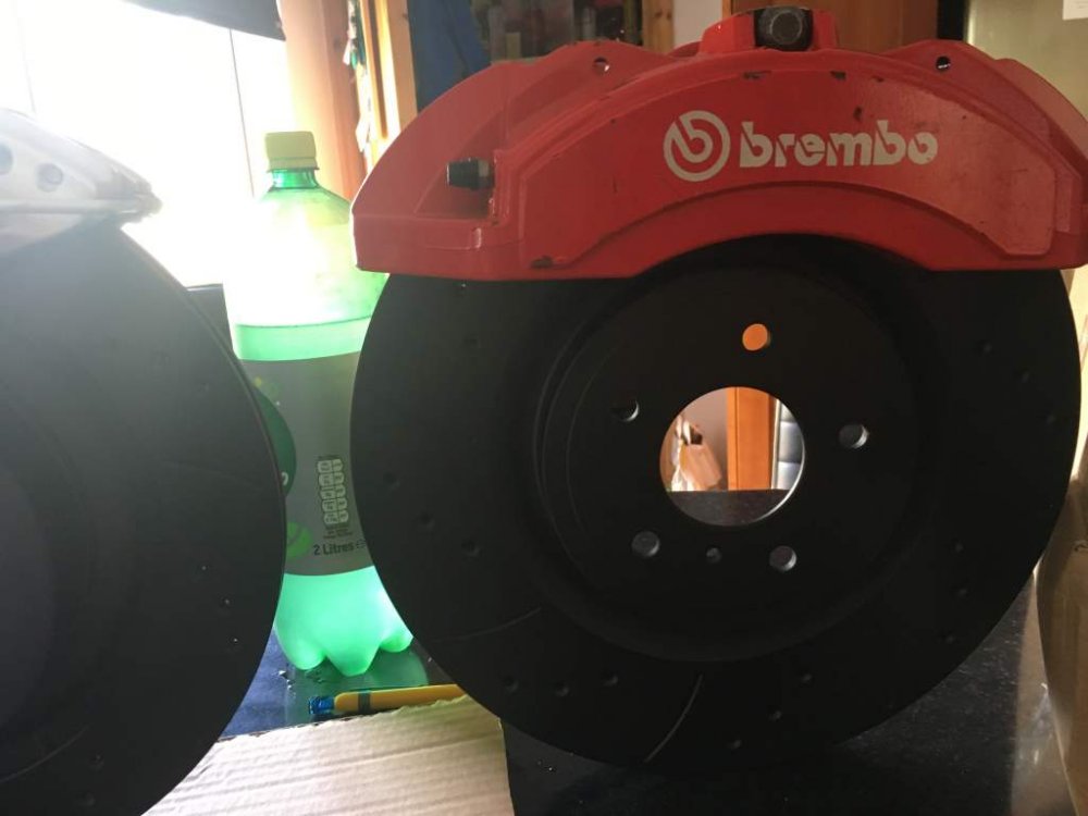

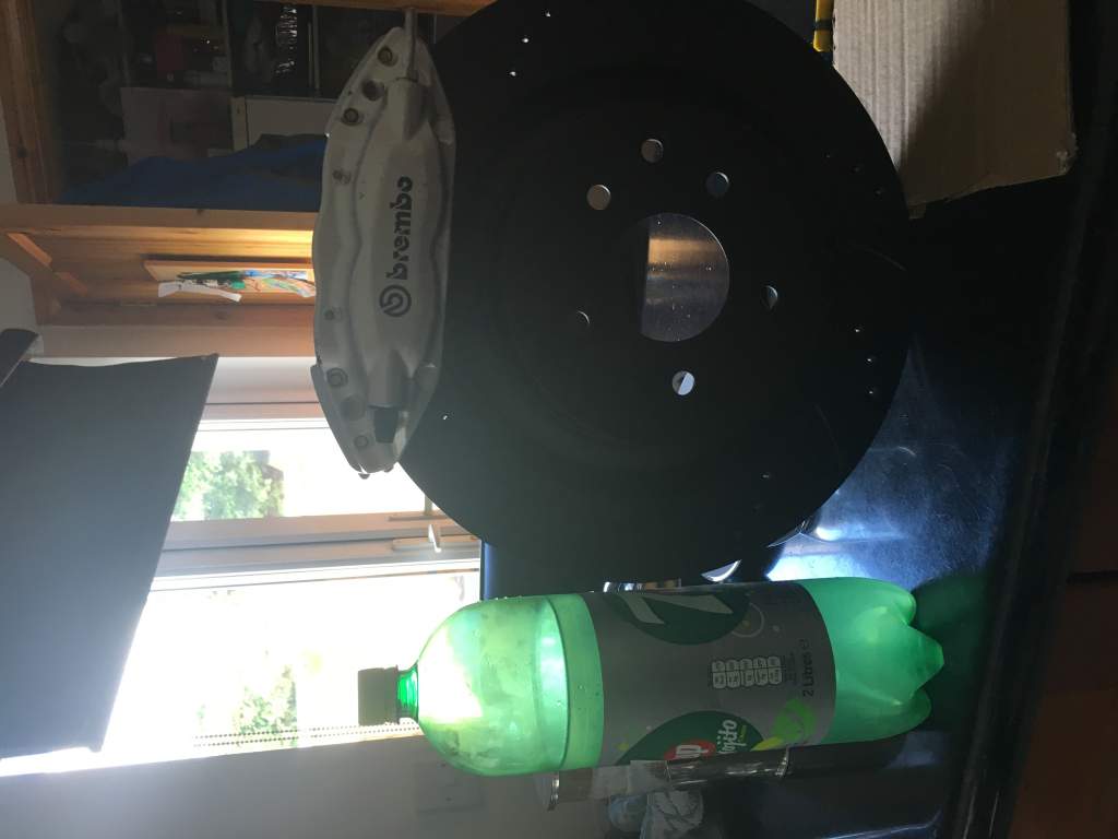

2 ltr bottle for reference
I've ordered rebuild kits for both the front and rears, new springs, pads and pins also, they're now fully stripped down ready for the powdercoaters, along with another full set of Evo Calipers:whistling::innocent:

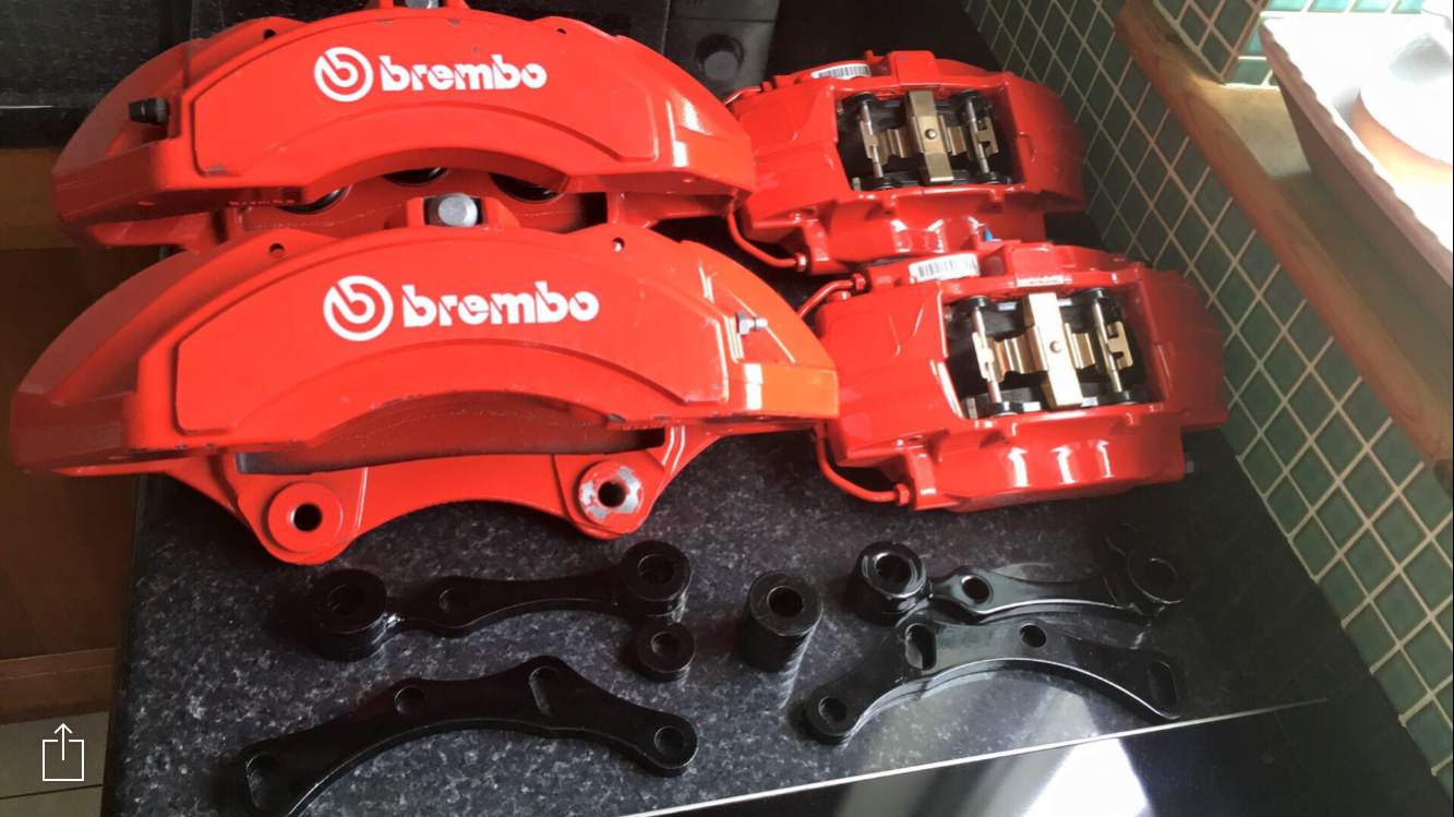

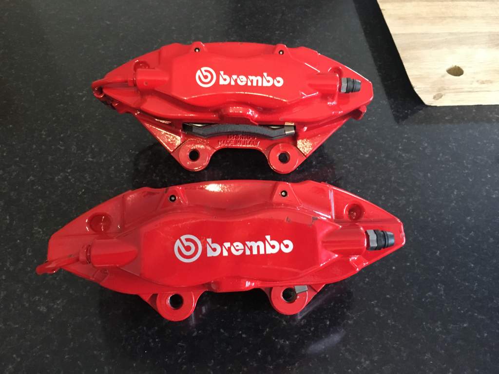

Finished modifying the Big Brembo calipers and dropped them down to the powdercoaters, ordered the fitting hardware (bolts, spring washers + lock nuts), stainless bleed nipples for both sets and the Brembo decals:thumbup1:

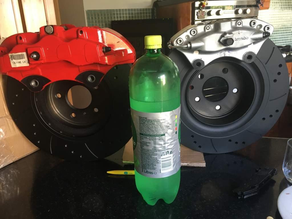

Good God Richie.......... what you stopping with those?
A Boeing 747...... They look soooooo nice......
You are going to be stopping and getting rear ended if your not careful......
I have a contact now, who's designing the brackets for all the large brembo calipers to fit Supra's 350z,370z and 300zx's. He's done a fair bit of research into brake bias and compatability. he's currently got brackets for the 17z and 18z Porsche, Audi Q7 and VW Toureg Calipers, all 6 piston fronts, he's also sorted brackets for the AMG 8 piston calipers:thumbup:

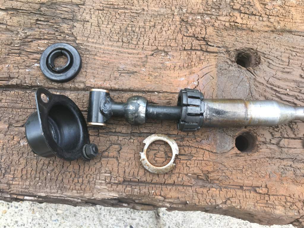

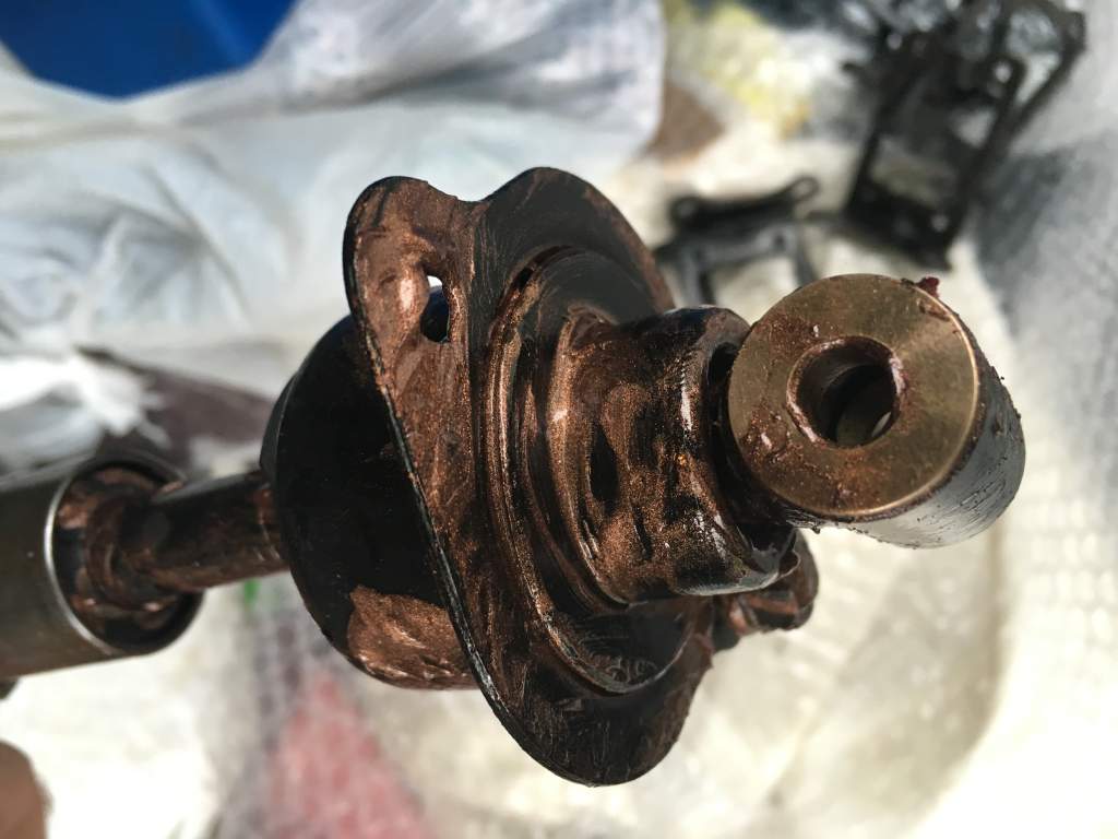

Started to rebuild my OEM shifter

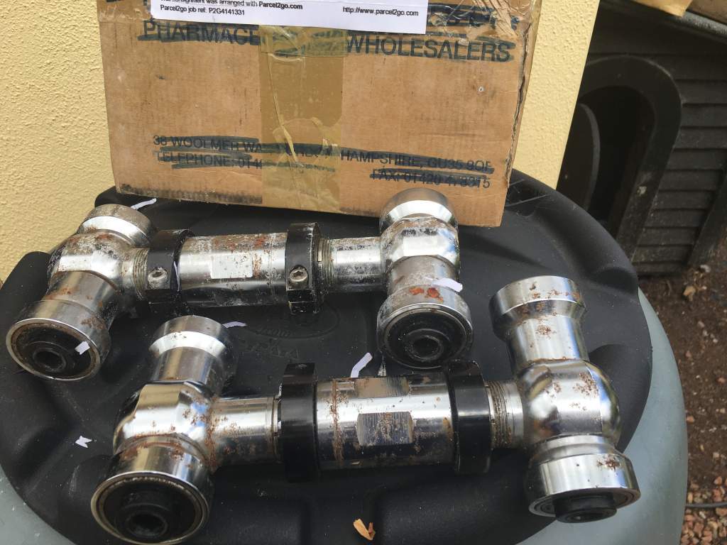

Found these few bits while rooting out everything
Powertrix FUCA's that I bought in 2010:thumbup:

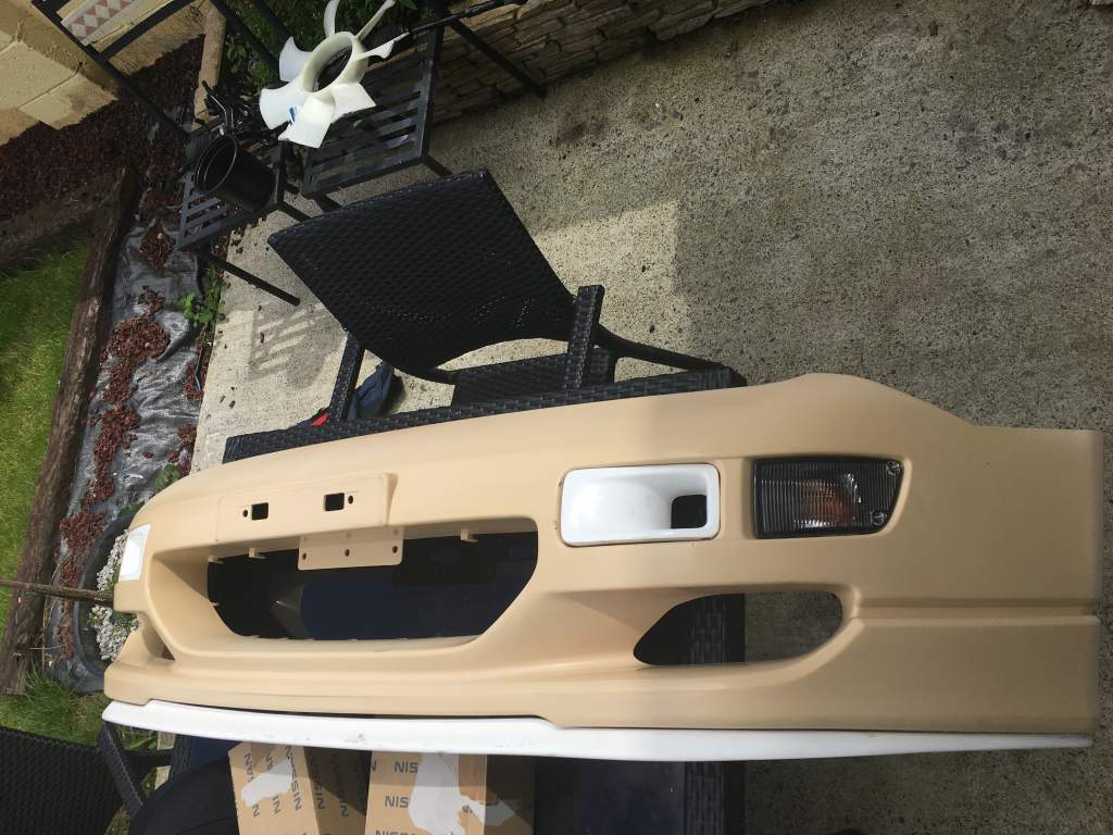

Pulled out the front bumpers, splitter, ducts and indicators,
Can't wait to get all this painted up, I'd say it will more than likely be over the winter now though, the car will be going in for the turbos etc in the middle to end of August. Remap after that and then will be looking at paint.

Did my shifter refurb, fitted new rubber bushes around the pivot and the bronze bushes pushed in, Hopefully copper grease is ok??? (Let me know if it's not suitable guys). Went to swap it out and lost my no.12 spanner down onto the gearbox!!! Put it all back together so the car can be driven back in at night and will get the spanner when we pull the engine if it hasn't fallen down this evening:thumbdown:

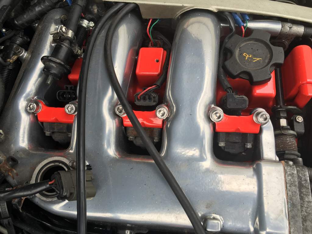

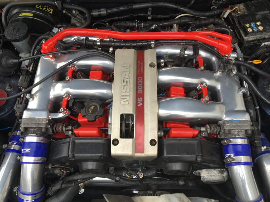

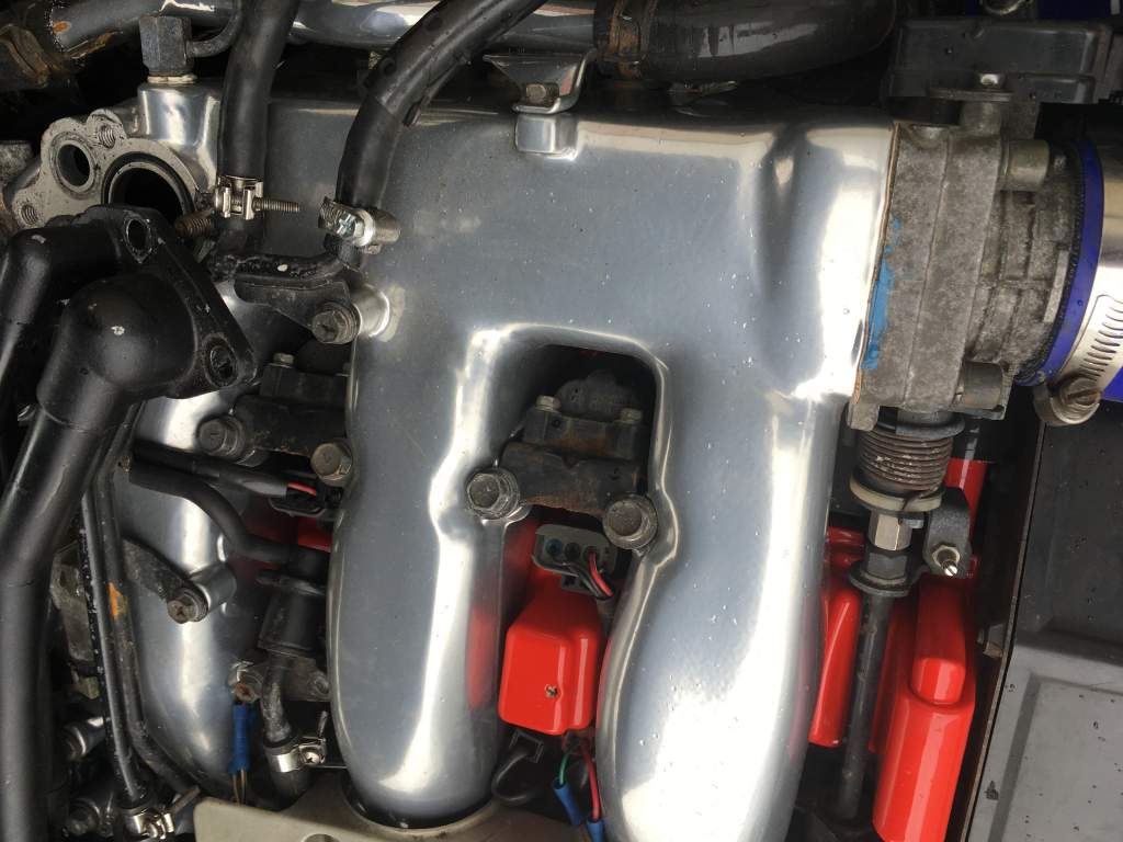

Fitted my powder coated coilpack brackets with stainless bolts and also the balance bar. One of the plenum mounting points snapped off:scared::thumbdown: Not sure if the powdercoating process had softened up the metal or what as I wasn't tightening them down that much.
After

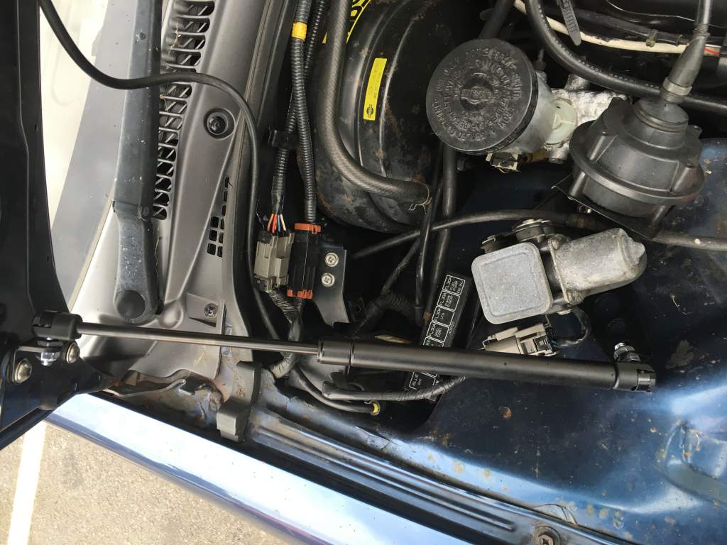

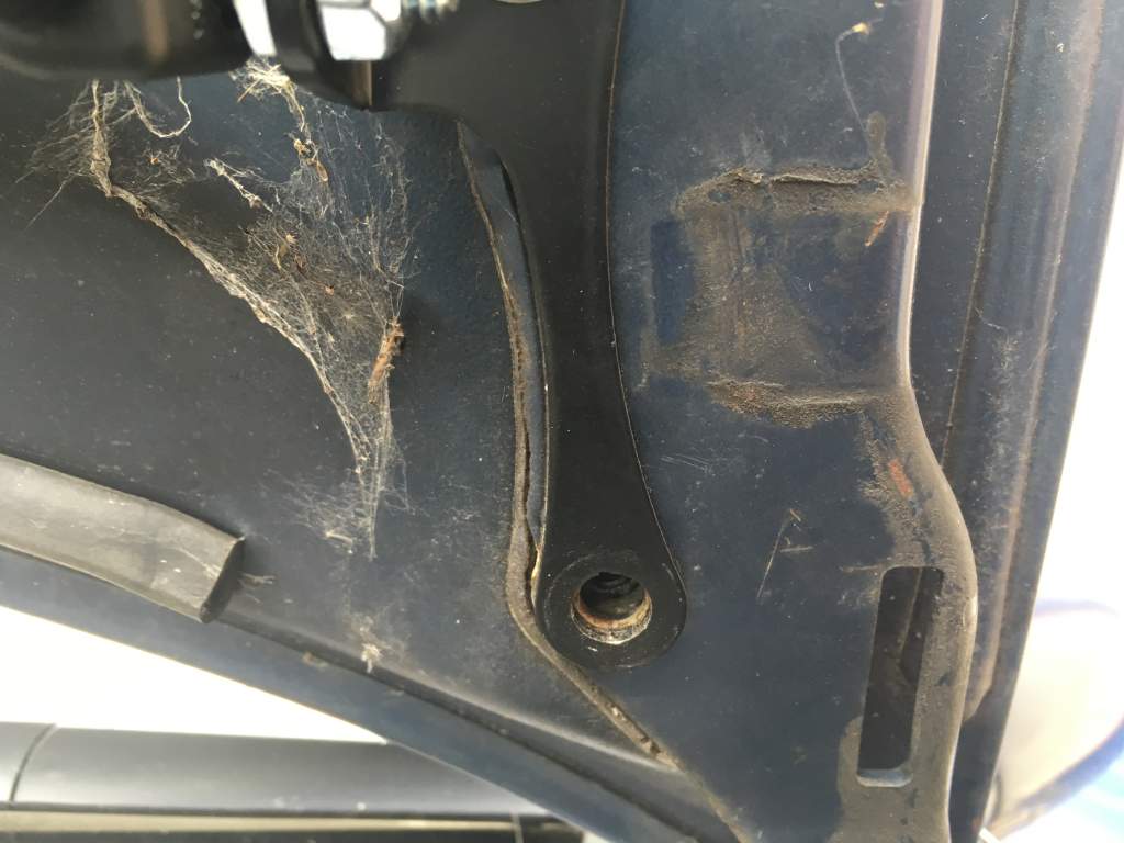

Fitted my Winfactory bonnet struts, they could have marked which bracket went where instead of trial and error, more issues, as my car didn't have a bolt on the bottom passenger side bracket, I was happy to fit the new Winfactory bolts only to find that the reason there was no bolt is due to the fact that it just falls back out, must be threaded. This is means that the struts are putting too much pressure on the bottom corner of the bonnet, can I do anything to rectify this??
Edited by Richie K
Another shot of the struts
The bottom of the bonnet is pulling / pivoting away from the bracket.
Any ideas??
