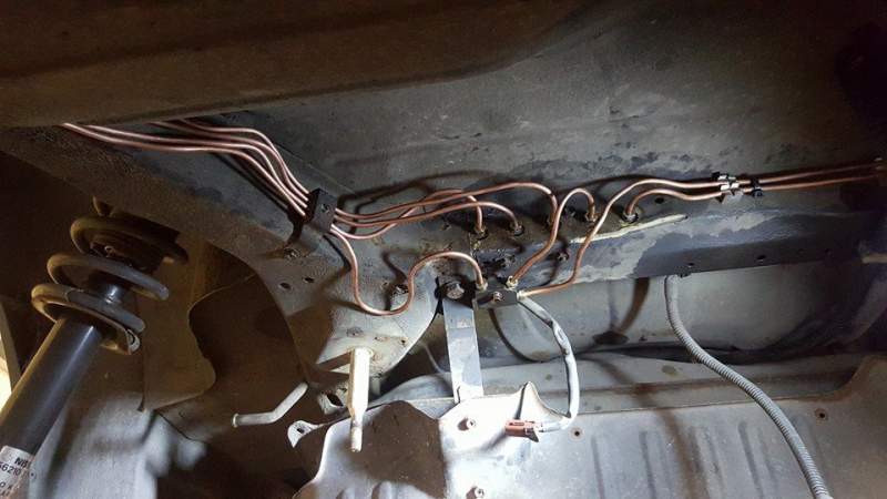

Normally when i do this on customers cars .. i find dropping the sub frame as a whole far more better ... that way you have all the room you need and you can do a Nice job of routing them
Heres one i did few weeks bk
Edited by MarkDerby
Would give me a good excuse to replace all the cracking rubber with polybushes I guess. And the diff oil cooler pipes.
The diagram is great Mark thanks.

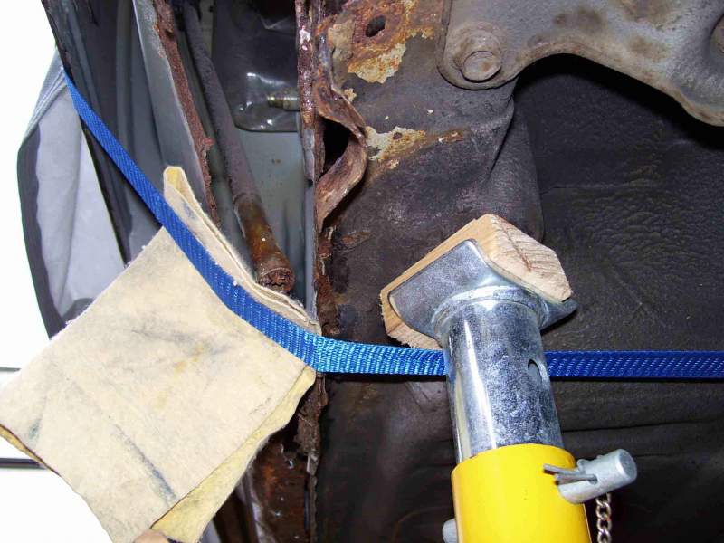

Please don't support the rear of the car on the sills or jacking points, they are just not strong enough.
I will dig out some pictures of how I supported mine.
Please see below.
Edited by redwine300
Above is a close up of one of the two designated rear lifting/support points.
Just inboard of the rear sills around the targa drain points.
Hidden by the block of wood is an oval hole for reference.
