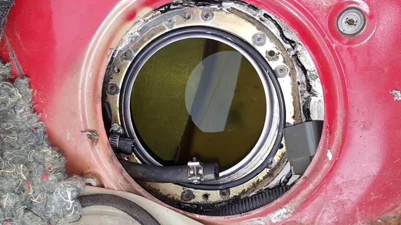

I have also found after checking my fuel pump that the gasket doesn't fit correctly. Seems to have stretched somehow... this explains the fuel leak when I full the tank up full. But still not starting

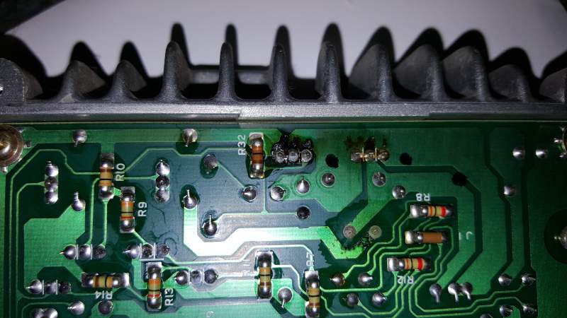

Took apart the fuel pump ecu and this could be the problem. Burnt circuit board in places
Sorted for now. I have hardwired it so it runs at battery voltage all the time. Starts and runs but ticking like mad. Picking new unit up Monday :D
Thanks guys. Someone has one near me so I am going to pick up Monday. Really appreciate it though. I will bear in mind if that is also a dud :D
