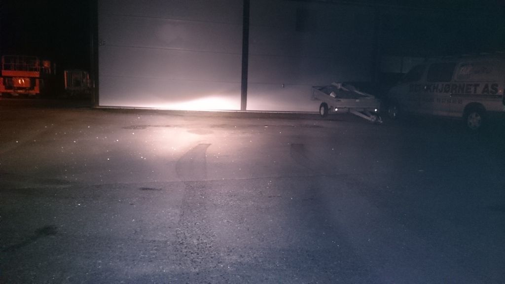

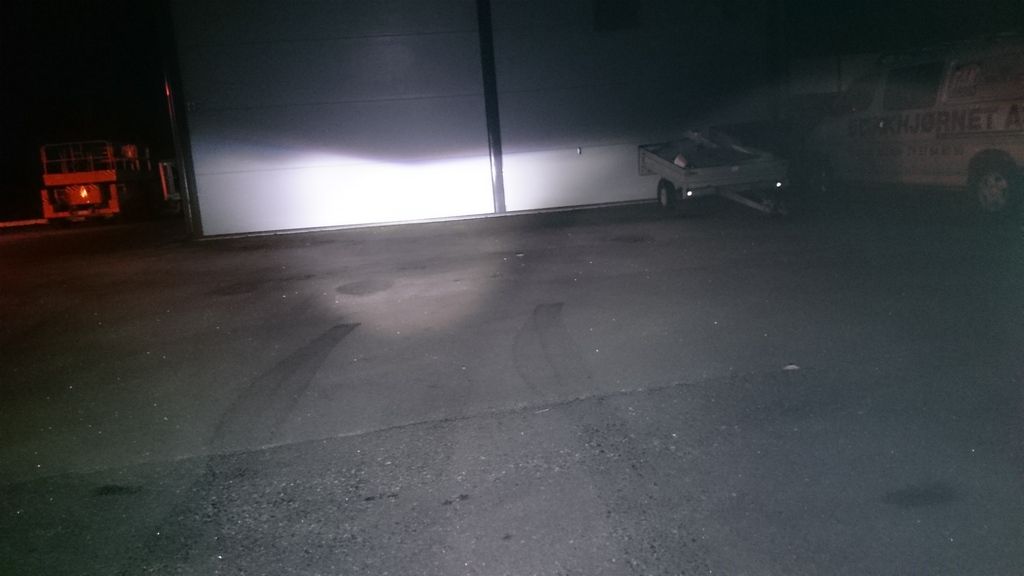

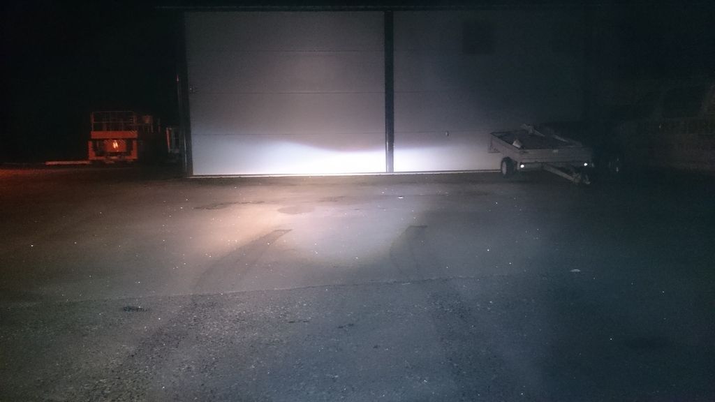

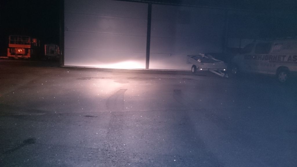

I ordered a set from eBay, got them today.... Didn't fit.... Just barely fouls on the lip of the rubber boot. Also fouls slightly on the metal clip holding the bulb in.
I have one spare light so I'm gonna find a way to work it out. Gonna compare a stock halogen versus this before I commit so I know if it's worth it.
But it is blindingly bright, easily outshined the stock halogen just as it was lying on the radiator connected to the headlight wiring...
I took the spare headlight housing, removed the bulb holder and stuck the bulb in there so I didn't have to cut anything yet. I was more interested in just seeing the output of these bulbs...
Hence the halogen is lower than the led since it's sitting on the car and the led light is sitting on top of the radiator. Also my spare headlight was a RHD while my car is a LHD if you're wondering why the cutoff is so different.
stock halogen:
led:
Thoughts: First of all, bright! But by no means do I believe these are 4000lumens per bulb.... It seems more like in the same region as the stock halogens but with more white light... Maybe best case they're slightly brighter, it's hard to tell with the naked(and my untrained) eye.
Second: The hotspot seems more sharply defined, don't know how that plays out on the road though as a positive or negative.
