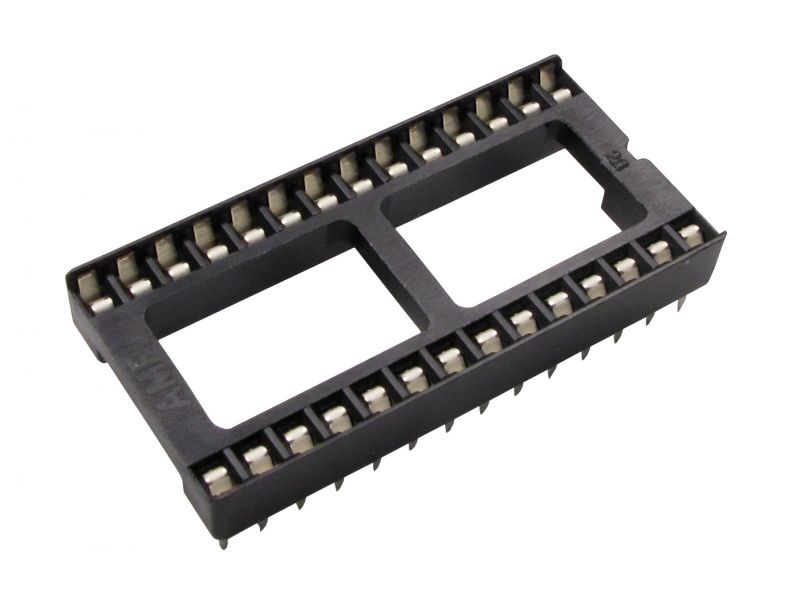

If it is one like this then it is a quick release with a release arm at on end??
Then you will need to ease it out a little bit each end so as not to bend the pins on the chip..... As AndrewG said....
Make sure you are earthed and don't damage anything in the ECU with a static charge.....
Or use Noel's way and go medieval on the little bugger........lol
Oh I see i didn't see the difference at first. I've got the pain in the arse version
Easy enough to pull out....... just ease it out slowly...... if you want I will do it for you? (gulp!!!!)....... lol
