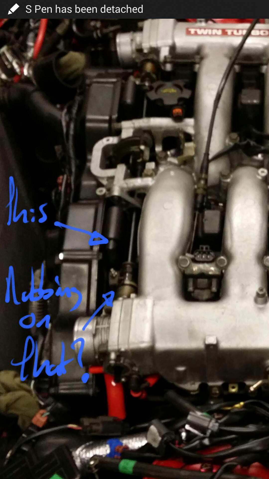

The throttle on my TT stuck wide open once. There are a couple of small metal breather pipes either side of the engine at the front, right next to the throttle linkage. I found the one on the left had shifted a couple of mm and was rubbing against the linkage, which sometimes made it stick open. Pushed it back in and secured with a cable tie - end of problem! Hope it's this simple for you. Good luck
ohh ill have a look, it started doing it after i converted it to a manual, and saying that those pipes were taken out when fitting new breather hoses at the same time as the conversion, ill have a look at that
As an alternative to the normal thing above... I found this on mine

Get it stuck in properly or maybe worth cable tie it for now. It can come out while your driving fast and you're stuck in excellaration mode which is a little scary. It's happen to a few people on here including me.

Glad you got it sorted mate. I second what bird says about cable tying it. Happened to me at full chat on a dual carriageway once, nearly a brown-trouser moment!
