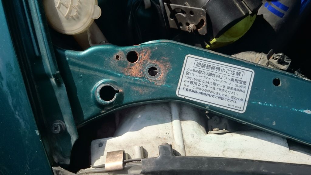

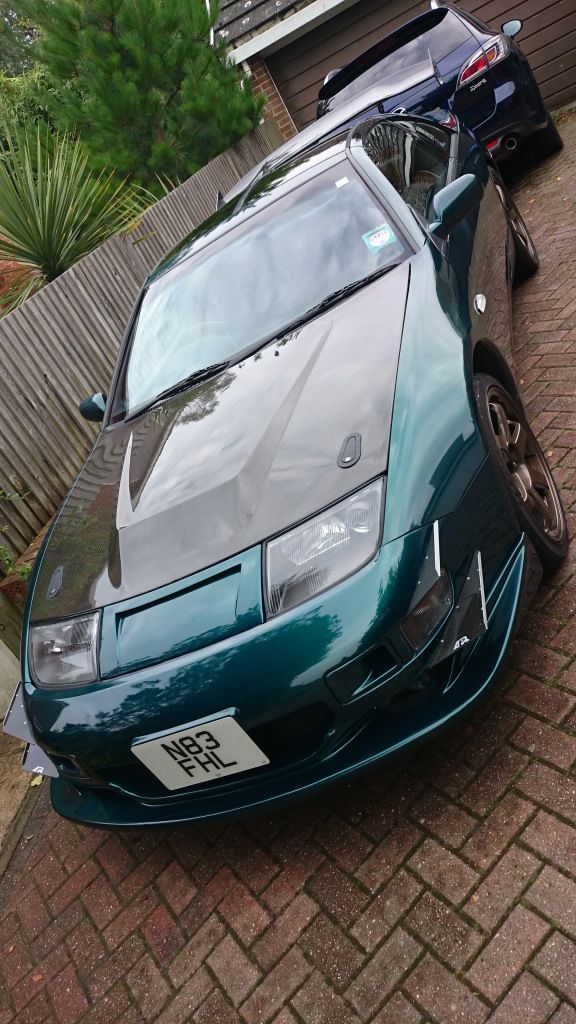

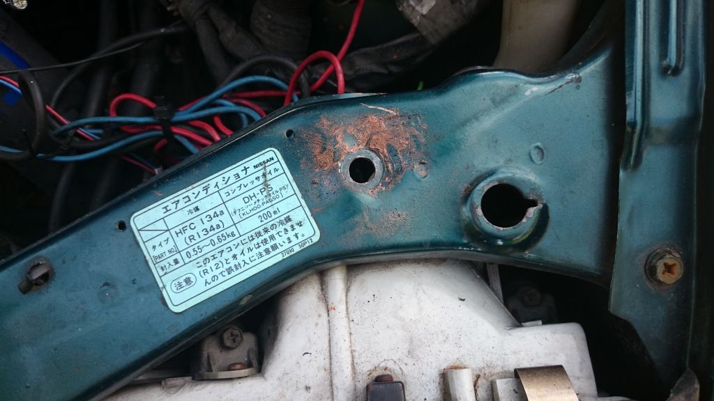

They are a pain to fit, here's where mine were fitted, ( not fitted anymore, I'd advise leaving the bump stops on and the oe catch if you've a fibreglass or carbon bonnet as mine flexed a fair bit.
Don't have the bonnet fitted anymore, but can take some pictures of the holes and the underside of the bonnet tomorrow afternoon if I get time.
