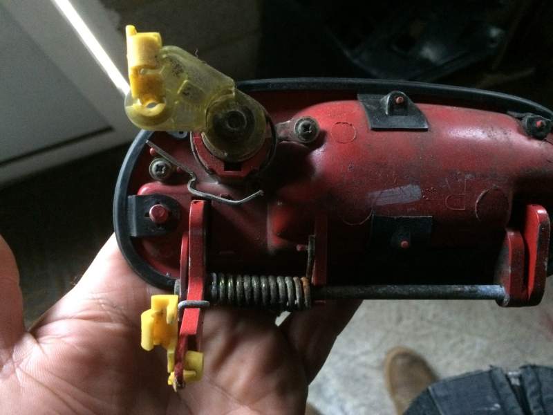

hi - I am desperate for the passenger side door lock assembly and drivers as well if poss - the part that goes from the back of the key lock and attaches to the linking bar - mine have died and only realized when battery was flat and would not open on remote - could not get into the car - happy to take complete assemblies please

I take it you really need the plastic yellow clips rather than the whole lock assembly.
If this is right then either talk to mark derby or Zedworld as they have metal replacements which will never break again.

not sure - with door handle removed there is nothing at all at the back of the lock cylinder for the rod to attach and cant see where the part required would attach
Below is the link to new metal replacements...
http://www.300zx.co.uk/forums/showthread.php?174871-Bargain-lock-quadrants-in-metal-here-now!&highlight=lock+quadrants
that's cool I will give zedworld a bell - thanks for all the help - much appreciated
