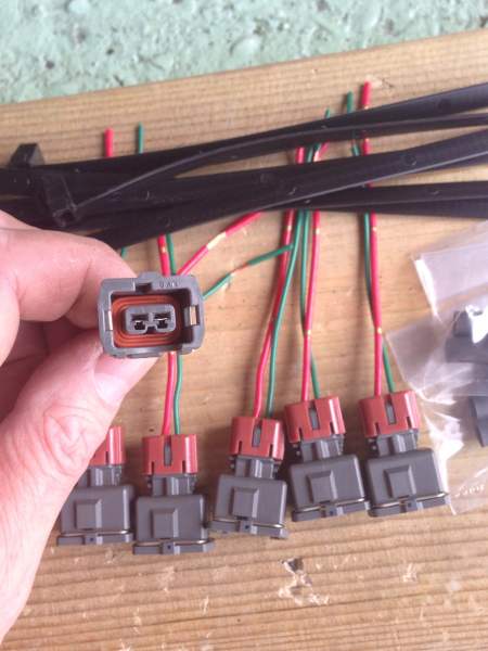

Bought these years ago, image.jpg can anyone confirm that they are for a Z32 and not a z31 please?
Old style z32 injector plugs according the Z1 site
The slot/channel on mine is off centre, can't tell if the photo on the z1 site is the same Graham
Ive just taken a look at some spare injectors in my shed and they are off centre

Cheers Graham your a star:clap:
I used a set of those on mine. they fit perfectly but the heavier red wire is the opposite way around on the original wiring harness so i switched them around before i soldered onto the harness. my original conectors looked like they had spent the last 21 years at the bottom of the atlantic along with the titanic when i unplugged them for a plenum pull !
For info, JECS EV1-style connectors, regardless of injector type (side/top feed):
Offset notch: High impedance
Central notch: Low impedance
