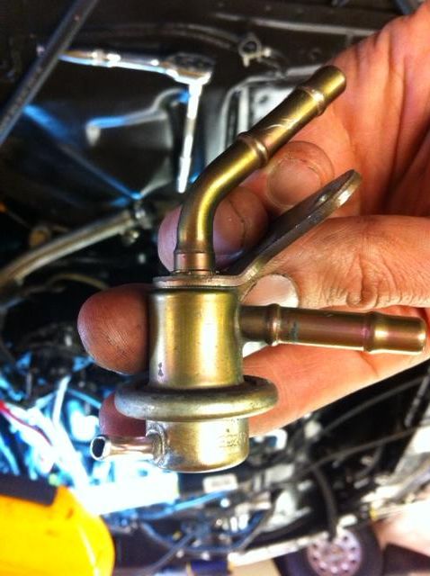

Can anyone tell me which way the fuel flows through the FRP? Is the nozzle pointing to the left the return to the tank?
Edited by Eggs
I have no idea why the pictures upside down when it's the correct way on photo bucket!?
The nozzle to the left I'm referring to is the short straight one of the two
Inlet: Short (side)
Outlet: Long (bottom)
Fuel flow: Tank/pump - filter - upper fuel line - dampener - rail - FPR - lower fuel line - tank
Dampener:
Inlet: Bottom
Outlet: Side
Cheers Noel just what I needed.
For some reason the picture displays upside down on my phone but the right way up on my PC?
