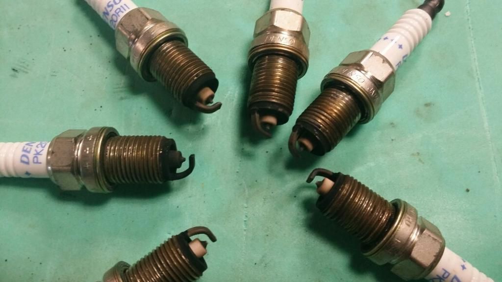

can you tell who the problem child is??
Any suggestions on best make plugs?
is it worth upgrading coils?
Go for NGK BKR7E if you're running anything other than stock boost.
The OEM coils are good for massive power (700hp @ wheels and counting). Upgraded coils are a waste of time.
6 new plugs, things a beast
