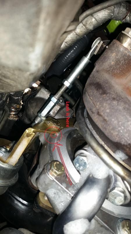

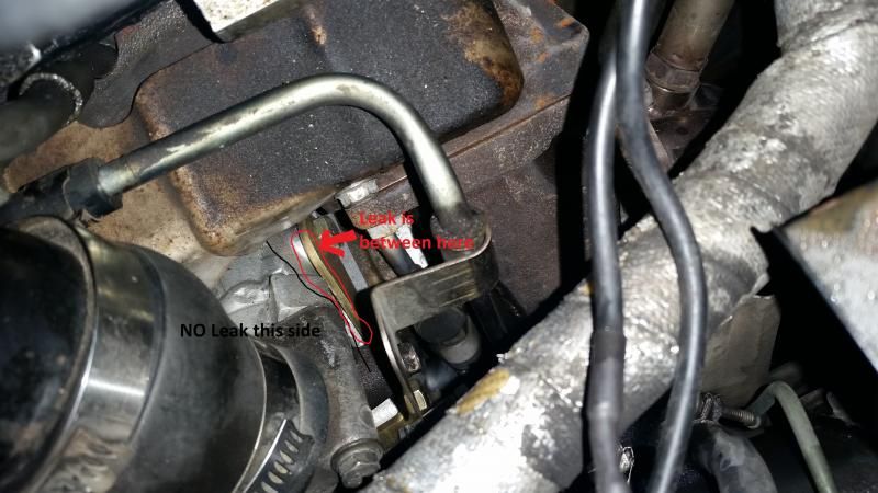

Found the leak, seems like its the side of the turbo. I have drawn arrows on the pics but I think I made them too small. It seems to me that the leak is between the shell of the turbo and the compressor bit?
First pic air is bubbling out of behind the gold clamp. No leak where the actual silver housing is that you can see.
Same again leak from behind the gold clamp.
What do you guys reckon?
