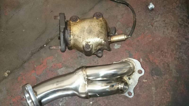

Hi everyone still here and while I've been free I've managed to sort a few things out on my z. Currently have completely removed both sides down pipes and cats today. Relatively quiet easy apart from the tight space and only snapped two pins. Questions is do I need to replace the sensors on both sides or am I ok with blanking them. Also the sensors that were in the cats there's no place for them so can I cut the wire or can I completely remove the sensor including wiring. Will there be any warning lights I'll need to address after. Another thing when removing the passenger side down pipes I removed the battery to gain access from the top and disconnected a pipe to make way and didnt think at the time but I'm hoping it isn't something bad

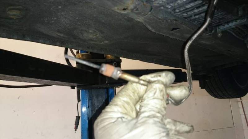

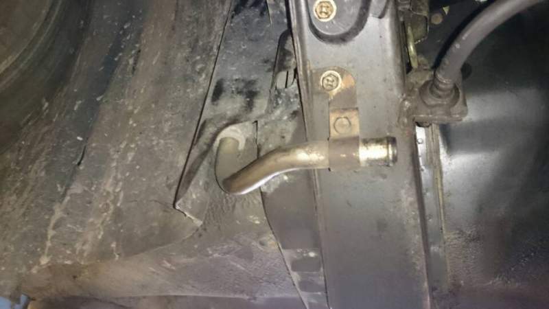

What do I do with these
Where does this lead to and what's it for

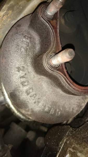

Turbos dry and clean no play so happy there :)

First picture looks like the air con system pipework, you will need to have it recharged.
The second picture is a cat overheat sensor I think so not needed, the sensor box sits under the center console, small back box with steel braided wires going into it.
Third picture if it's the front of the car might be part of the carbon canister system.
