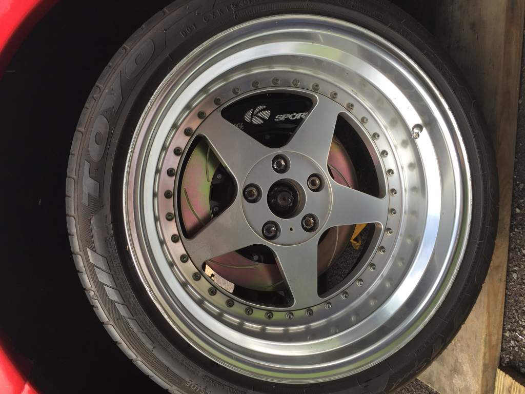

Well the 4 pot rear K Sports arrived during the week. Took a bit longer than I figured, due to adjusting the handbrake, once they were on.
These were a little 'snug' compared to the fronts I fitted the other week.
The finished job, (well less the centre cap)

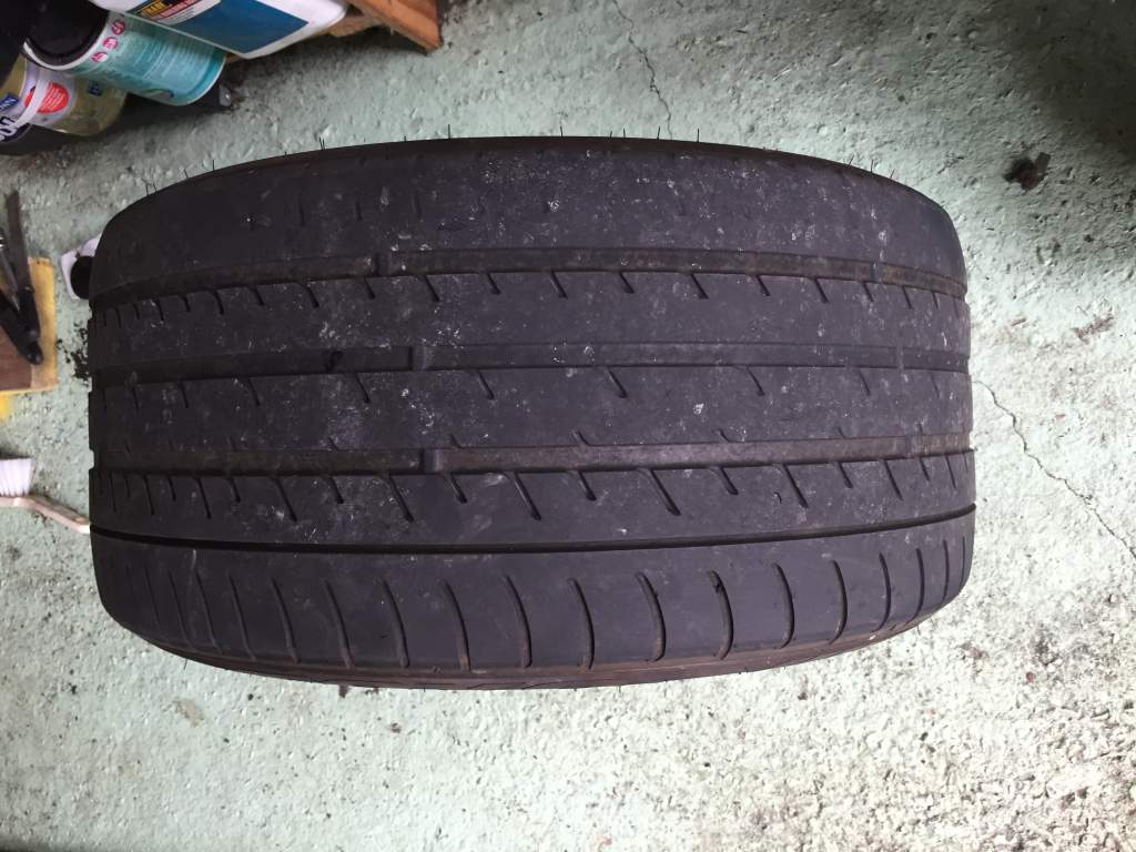

Just need some new tyres now aswell and then 4 wheel alignment as you can see in the photo, the inner half of the tyre has worn far more than the outer edge
